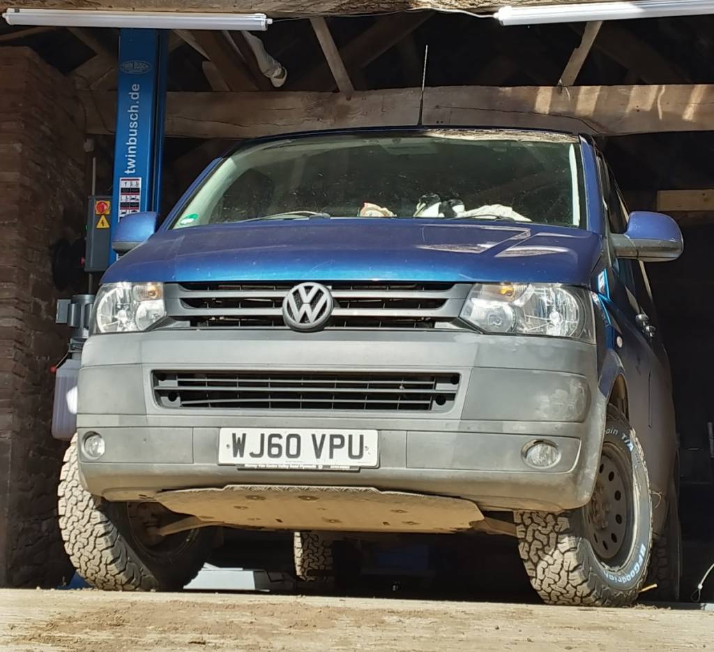

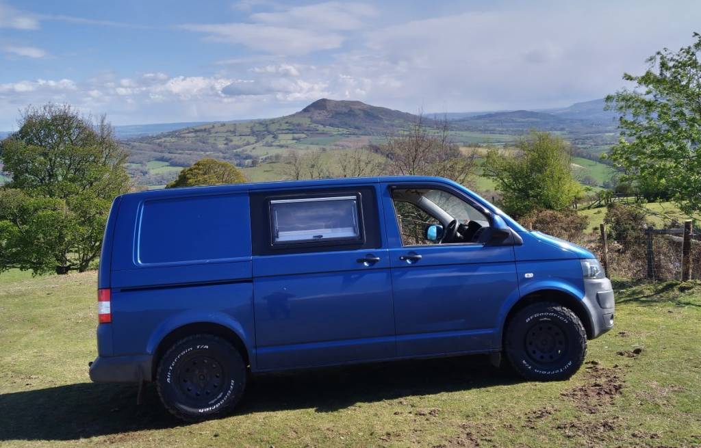

Just to add, lifting it will probably result in rapid wear of front CV joints and ball joints. Mine is raised by 40mm and I am planning to drop it back to standard one day as I am about to change out the 3rd CV joint and second ball joint in 3 years! Tyres are BFG All Terrains in 235/70 16 flavour

@welshfarmer is that the skirrid in the back ground?
Posted : 19/06/2023 8:53 pm
Posts: 5720
@trickydisco
indeed it is. On the hill above Dirt Farm (helping a friend who lives there and had broken down above his house).
