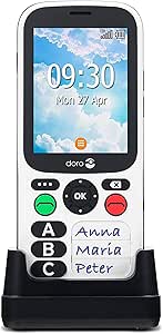

Its not great for older people who don’t understand tech.
What is there to understand once it's set up? Get a little charging stand, tell them it's a new cordless phone.
https://www.amazon.co.uk/Mobile-Phone-Elderly-People
I'd understand it if they were still sitting there with a paper address book and a rotary phone. It's just an excuse, Doro does one with three buttons for goodness sake.
