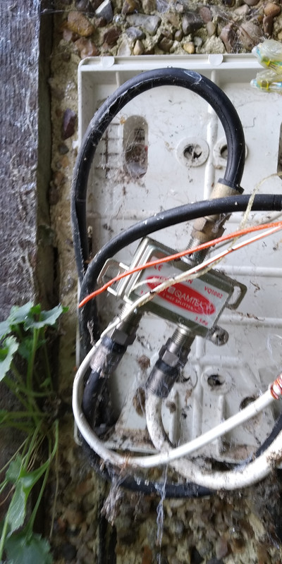

Have just checked the box on the outside of my wall. Obviously one cable to house that then splits.
One goes into the telly downstairs ,one to the hub upstairs.
Do they both carry the same signal, could I plug the telly cable into the hub, if not could I connect the telly cable to the hub socket on the outside of the wall?
It doesn't matter which cable you plug in to the hub or V6 box. That is just a simple splitter.

How many times is the coax being split now? Is the original splitter still in place where the cable comes up from the ground?

Cable arrives at house where it is split black upstairs for internet and white for telly.
We now only use the white cable as I've moved the hub downstairs. The telly plugs into the hub with a coaxial and ethernet cable .
Original splitter is still outside.
