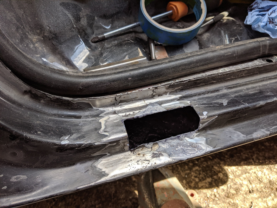

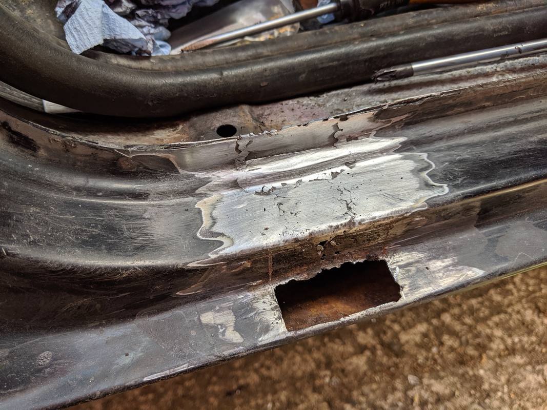

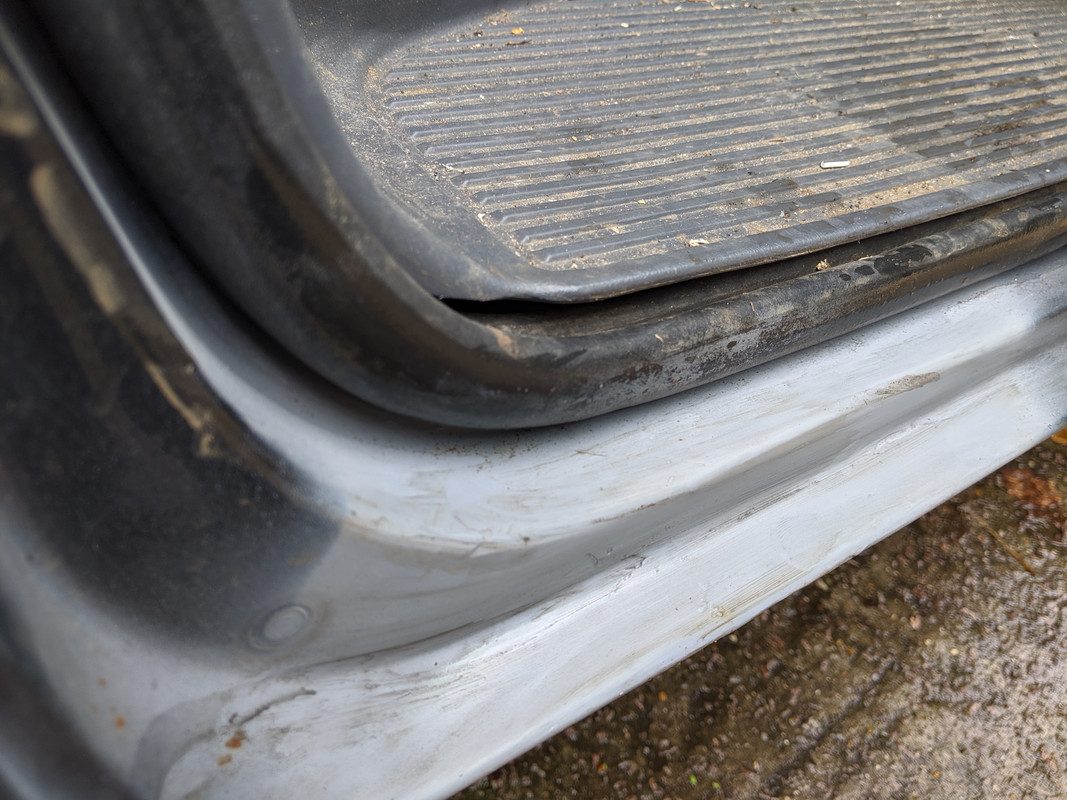

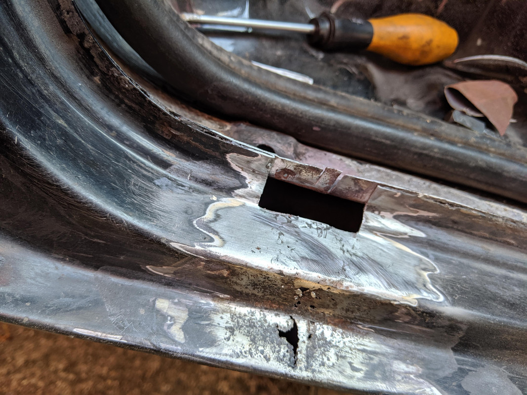

Oh yeah. I've stalled a bit now partly because of the rubbish weather, but I did tackle the drivers foot step first. Yet to put on a top coat though.
I got some steel off a mate, cut out the worst and splashed rust treatment everywhere, then welded some little bits in. Some slightly awkward shapes in there but it looks alright I reckon. Might keep the Wolf from the door a bit longer.
