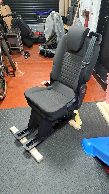

Right, I've got a Peugeot Boxer and some posh seats from a Transit Custom that are quick release, built-in seatbelts, isofix etc. I need to nail them in somehow, in a way that won't endanger the lives of the babies and grandparents strapped into them.
There are 24 nuts and bolts (the factory Ford ones), 4 in each of the 6 rails. I can arrange the seats the way I want them so they sit on the flat part of the floor. I thought I could use lengths of angle iron as spreader plates, but long ones that go perpendicular underneath all 6 rails, tying them all together. Rather than a seperate bit under each nut. Anything wrong with that idea?

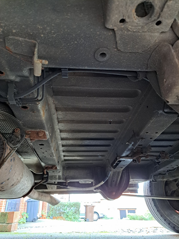

The problem is that some of the bolt holes will be obscured by the chassis rails. Any ideas for solidly mounting the rails in the parts where I can't access the backside? Can you cut big holes in a chassis rail to access a bolt?
This is what we're dealing with...
These things are bloody heavy!!!
I'm willing to pay to have this done professionally but I've already been denied by a couple of local (Sheffield) firms. One welding/fabrication place say their insurance won't cover them and a van conversion place said they can't because they don't do welding or fabrication.
For the past 6 weeks I've been thinking I should sell the lot and buy a Jimny and a bike rack. If I can get past this blockage I'll hopefully get my mojo back.

Extra long bolts or screwed rod for through leg a possibility. deffo wouldn't cut actual holes in rails. also you could mount seats on say a 6mm plate with countersunk bolts and then once seats bolted onto plate then bolt plate onto floor where you can screw onto floor where there are no chassis rails (put some plate underneath to ensure thin plate van floor doesn't rip in crash) Also You tube search will give options to you

I'd be wanting reinforcing above also unless mounted directly over a chassis member.
Van floor alone won't resist rotational load punch through in a frontal impact.

I've done seat belt anchorage tests on converted vehicles and seen plenty of failures.
Ideally I'd be wanting the rearmost two rail bolts just infront / behind that rear crossmember, mating with fabricated spreader brackets under the vehicle so you are clamping both the floor panel and fully around the crossmember. No idea if the bolt spacing is wide enough to allow that.
Not sure where that leaves the front bolts. Ideally you want the front of the rails overlapping that front crossmember so they don't punch through the floor, but you could use an inside vehicle spreader plate to achieve that.
Your angle section spreaders under the floor aren't a bad idea. Channel would be better than angle, and you want to be tying into / around the crossmembers, not just through the flat bit of floor. I'd be getting a fabricator with press brake to make a length of bespoke channel with one short stiffer leg and a long leg to mate with the crossmembers.
Don't use threaded rod - it is garbage. If you need long bolts then order 12.9 grade capheads or similar. I've seen failures where purchasing buyer thought it was ok to save a few pence swapping high grade bolts for threaded rod.....
All this is just slightly more informed than normal internet advice - you are doing this at your own risk....

The spreader bars underneath is great, but especially as you have built in seatbelts you really need to consider the rail pushing down at the front and ‘punching’ through in the down direction as the rear try’s to lift up.
As the poster above, you’d need to be tying in/straddling the chassis cross members.

Have a look at the kits used to mounts RIB beds - sort of spreader plates bolted to cross members and then bolted through to fit seats. Clearcut Campers

Thanks for all the info there's a lot of useful stuff here. It's all stuff I already basically knew, such as heavily reinforce all mounting points and tie around the huge chassis rails rather than go through them. That still leaves me with the problem of finding someone to do the work as I'm not really set up for it at home.
I've been dealing with my other nightmare all day today, the collapsed bedroom ceiling.
I'll jump in the van tomorrow and shuffle the seats around. They're so bloody heavy that getting them in and out or putting them in the right spot is very hard work. I'll find out how many bolt holes I can tie together with U-channel steel and how many I can't access.

I got mine fitted by Motorkraft in Stoke, they issued a certificate as they are an approved installer for a few brands of seats.
Plates above and below the floor with high tensile bolts, all supplied by seat manufacturer. Insurer wanted certificate and photo of seats.
Posted : 28/01/2023 6:56 pm
Just in case anyone is concerned, I could have got much less expensive seats and screwed them down with self tappers. However I plan to carry my infant son using his childseat and the isofix points. Whatever I do it'll be well in excess of whatever you find in a standard van.
