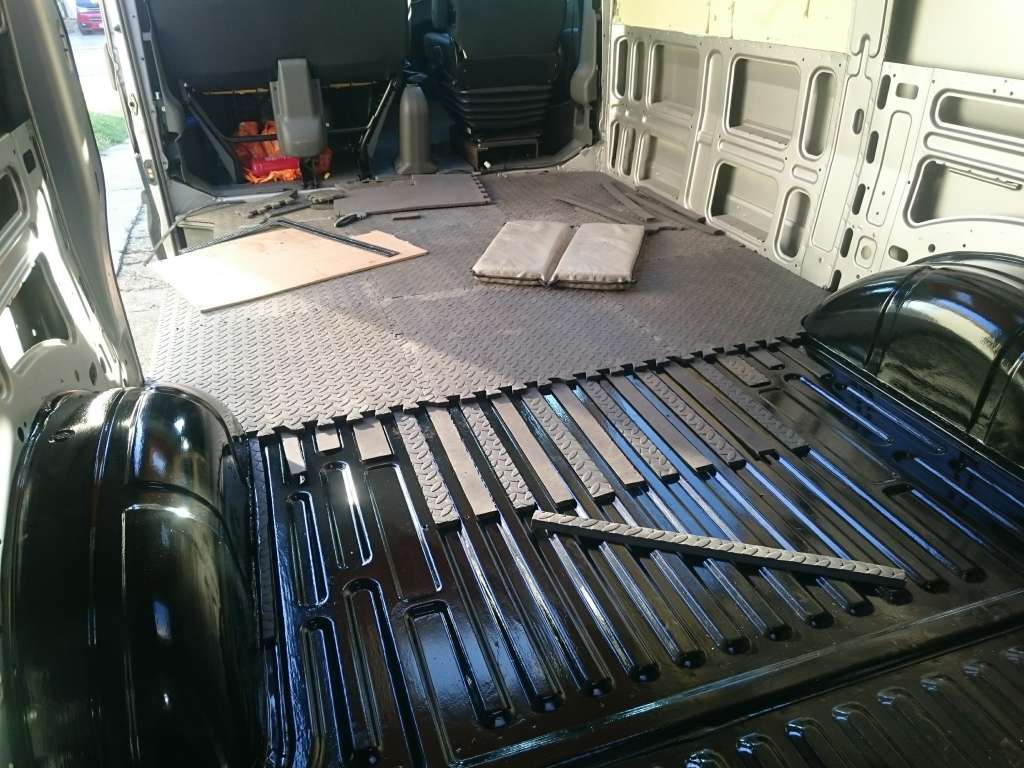

Posts: 11486
I've converted two vans (of the same type.
The second was considerably quieter, the difference being that rather than ply screwed to the floor, or battens and insulation board followed by ply, I put a layer of those lightweight foam floor/gym tiles down (and cut a load into strips to fill the grooves in the floor) and then laid ply over the top (using half lap joints between the ply sheets as a butt joint would need a batten).  Then a bead of PU adhesive round the edge... the result is the ply is completely isolated from vibration and all the noisy stuff under the van (tyres, suspension, gearbox, engine, exhaust, diff and stones etc)  I didn't bother going under the cab mat as that's already fairly thick.
DSC_0935
I also fitted some deadening tape to the walls, it does make the panels sound less boomy but nothing like as effective as doing the floor.
