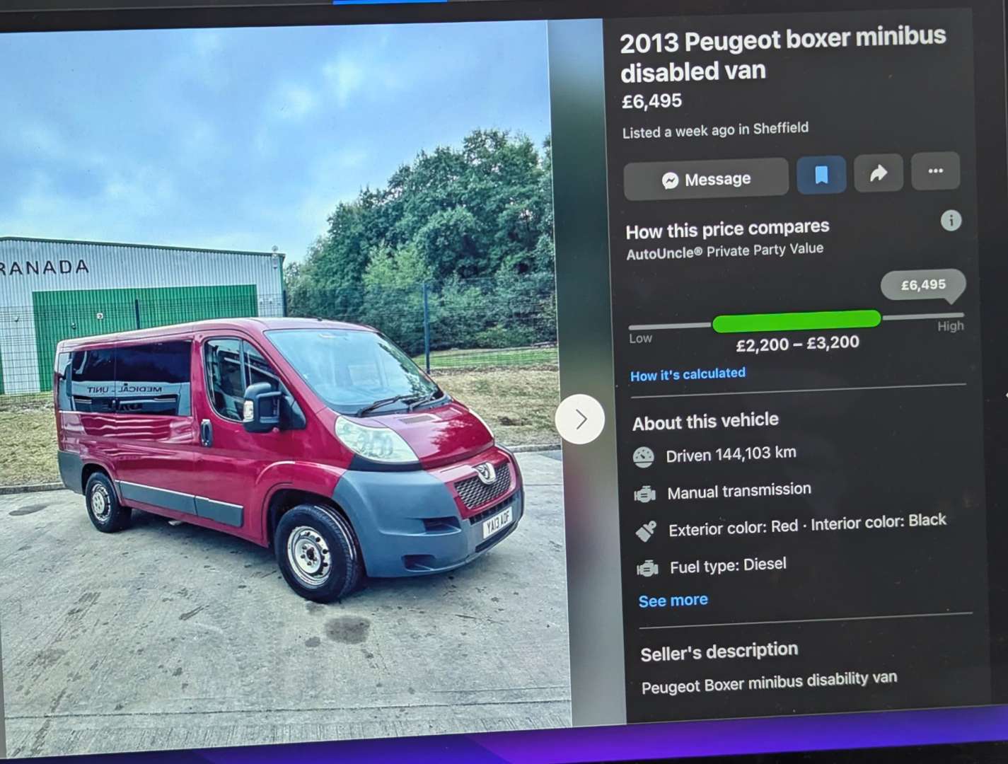

Buy this
Council wheelchair van. CAZ exempt and for sale in Sheffield.

This forum is shite.
It's this one...
I had one of these for about 18 months and I really liked it but mine was just a panel van so when the CAZ kicked in I sold it.
