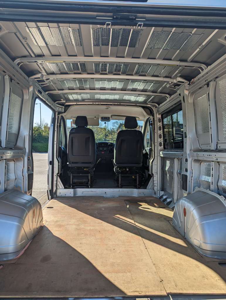

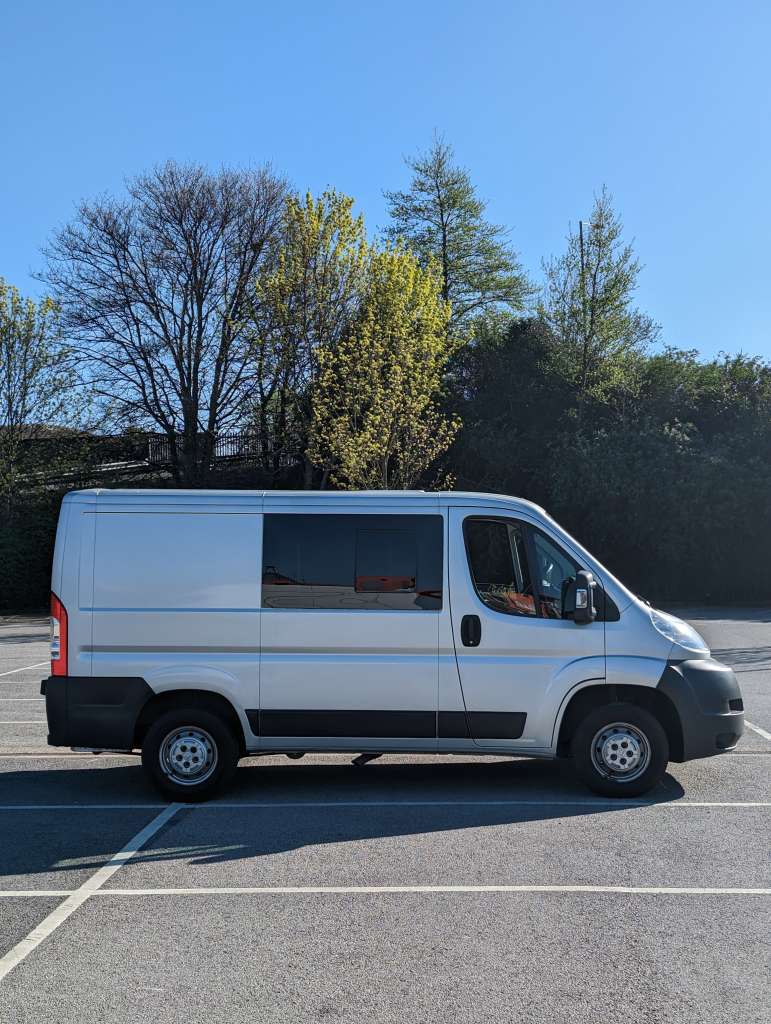

I had a Boxer for just over a year. I only drove it 4 or 5 times because of work and kids and it was loud, slow, thirsty. After having a long line of vans something in me died while I had this one and I just couldn't be bothered with it. Can't remember if this was a 2.0 or 2.2 but it was the 110bhp model.
PXL_20230419_155121968PXL_20230419_155007549
I cleaned it out, added £200 worth of Dodo Mat, fitted the side windows and some BMW seats using a single passenger base. I had some very expensive removable rear seats from a Transit to go in but I sold those separately. Then for some reason I was just sick of looking at it and didn't enjoy driving it so I sold it.
The body was good even though the paint wasn't. Absolutely no rust anywhere, even where the previous owner had drilled holes in it, which I've never experienced before.
Now that I'm getting van-curious again I wouldn't mind driving the newer model with a bit more power. I keep looking at wheelchair vans because they already have windows, roof linings, floors and usually a Webasto diesel heater. This is the biggest van that fits on my drive without poking out in to the pavement but for what I need I could look at Vivaros/Trafics.
