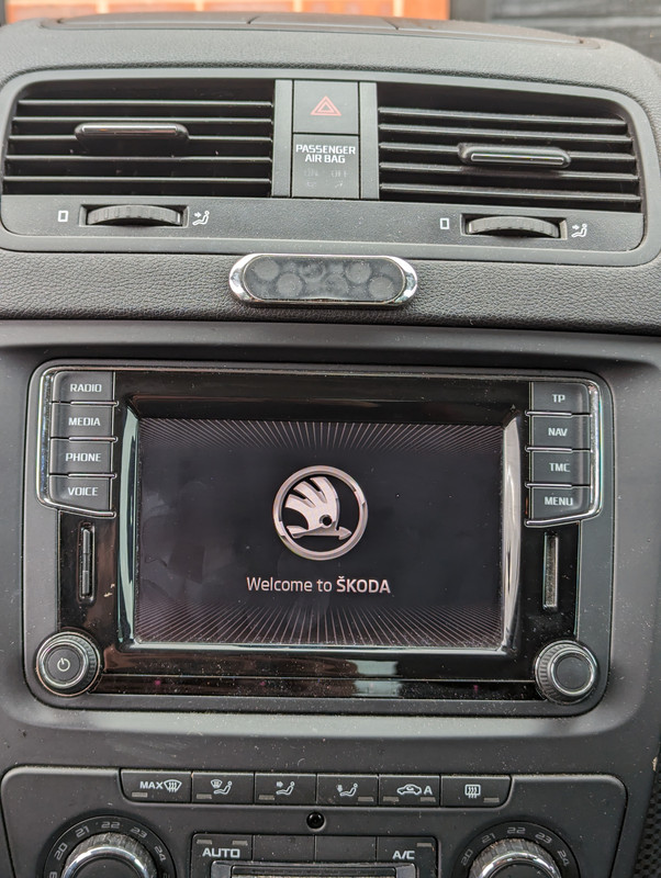

We have a Yeti Monte Carlo with a faulty head unit.
It went for an MOT and service last week and was supposed to be up for sale by now but the bloody radio has stopped working.
The head unit just blacks out and slowly reboots constantly. Sometimes it lasts a few minutes, sometimes we get 10 seconds.

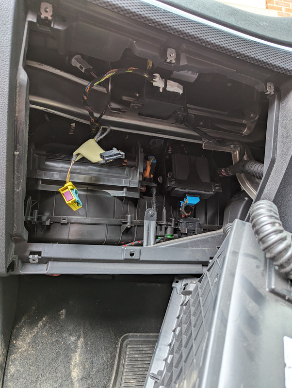

Thought I'd have a look for the 5F unit in the glovebox but not sure which one of these little boxes it is yet.

Ah ok, if yours is a 2015 then it probably doesnt have the 5f thing in the glovebox.
If it did it would look similar to this:
[url= https://i.postimg.cc/pVq2MWf5/Whats-App-Image-2024-04-14-at-18-59-42-59226528.jp g" target="_blank">https://i.postimg.cc/pVq2MWf5/Whats-App-Image-2024-04-14-at-18-59-42-59226528.jp g"/> [/img][/url]
Posted : 14/04/2024 7:11 pm
Nope definitely not! Well at least I've had a look.
I'm on the lookout for a head unit locally but found nothing yet.
The one we have looks like this...
Posted : 14/04/2024 7:16 pm

Looks like an MIB2 - a VW RNS510 without the spinny discs and 2 card slots.  Also known as a VW Discover. Basic integration to the car over canbus (you’ll get steering wheel controls, HVAC, parking guides, some limited info in the MFD and a speed input for the nav in tunnels).
VCDS or Carista can probe it. It’s unlikely you’ll get much back though other than software and hardware versions.
Try removing the SD cards and any leads first (ours is very sensitive to faulty lightning leads), then attempt a manual reboot by holding the power button down with the engine on until you get the skoda logo and welcome message. I would suspect there’s nowt wrong with the hardwear and you’ve got some corrupted firmware.  Unfortunately VW no longer allow you to download firmware updates yourself as you could with the older 510s. A VW specialist would be my first port of call.

Now that I've removed the glove box and disconnected the passenger airbag switch, we have a dash light on for a faulty airbag. Even though it's reconnected and back the way it was.
I've tried the car scanner and it doesn't throw up any fault codes.
This car has been absolutely faultless for over 2 years and it should have been on eBay this week with a full 12 months MOT. Now I feel like it's going to start rinsing me for money.

If you fire up any vag car with a break in any of the airbag circuits it will ping the airbag light on.  It’ll need resetting with vcds /Carista or I think any OBD2 scanner as it was part of the original legislation.
