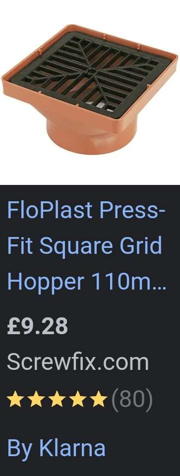

Posts: 11486
Dig a small hole outside your cupboard/shed, chuck a bucket of gravel in and then set something like this on top.
If new plumber doesn't like the current set up he presumably can just fit a tundish and install a short waste pipe to the grid. (Maybe put an elbow below it so it's a bit more secure in the ground and not obviously full of gravel!)
Screenshot_20231006_060549_Chrome
