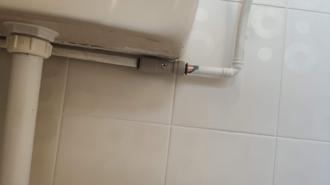

Hi, I rejigged it so we had independent heat no longer provided through the floor and isolation on the pipes so I can put up a false ceiling with insulation.
Three of these for other reasons
Thanks all
