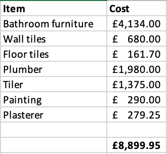

I'd say price is about right, here's the breakdown for ours which I would say is on a similar scale (but was start of covid as opposed to post-covid prices);
Plumber and Decorator were Dads from school, don't think I really got mates rates but were hopefully not ripping us off! The plumber arranged for all the trades (bar decorator), but we paid them separately. We got furniture (bath, walk in shower, loo, sink, cabinet) from Sanctuary Bathrooms online and was high-ish end for most stuff. There was a fair amount of rejigging of layout/pipework.
EDIT; Just re-read and realised your £9k doesn't not include the furniture - so I'd say it's rather over the top.

Update. The "top end" bathroom fitting is dragging on rather. Been here 3 weeks. Whole house filled with dust. Came back oneday to find they had laid the floor and it was shocking. Irregular spacing and tiles not level. Redone that. Not totally perfect but not far off. Floor is now an inch higher than the adjacent room.
Now they've mostly tiled the walls I've noticed a few small chips at the edges of some tiles and not all the tiles are completely flat to each other. Apparently it's a difficult job because the walls aren't flat. They ripped the walls back to bare breeze blocks then stuck big black panels about a centermeter or so thick on. These weren't perfectly flat to each other (should they be?) then they are tiling on to that. In places the tiles are out much further than the original tiles such as proud of the original door frame. They said they will fit beeding?
Also the bath was put in 1st then the black panels then the tiles so the gap behind the bath tap to the tiles is only a few mms and there is not much space left on the edge of the bath where it meets the wall. Is that normal practice? How on earth they will seal behind i don't know!
I suppose I'm wondering what level of perfection re tiling i can expect if my walls are wonky and whether to just ignore the minor defects or do we get them to redo or ask for money off as they are already running late and I'm pretty sick of having them in the house now 😞
Posted : 17/05/2022 6:42 am

Posts: 16346
Pretty much everything about that sounds poor, especially if you are paying "top end".
Posted : 17/05/2022 6:56 am
Posts: 4421
If they’ve reboarded into the block work then there’s no excuse for bad tiling. I certainly wouldn’t accept any chips, lipping is just poor work.
The floor sounds like they overtiled again, unless you have underfloor heating?
The board should be down behind the bath edges also, so you can get a good silicone seal before tiling.
I’m afraid it doesn’t read like “a top quality job”. Having said that 2-3 weeks is normal for a bathroom if plenty of work and changes are involved.
Posted : 17/05/2022 7:10 am
Posts: 6257
I think it's already been said but that price for a 1.5x2.5m room with no tiles or furniture seems exceptionally spendy to me, given a) I've fitted bathrooms before and b) I'm used to St Andrews prices. And then the snagging list you appear to be accumulating...?
I think you probably know by now that this is not £9k of 'top quality' workmanship. The decision now is do you try to get them to make good or kick them off the job and get someone else in to finish properly, and bear in mind the 'sunk cost fallacy' when you make that decision.
Posted : 17/05/2022 7:34 am
Yeah, it's their job to achieve a level surface for tiling, are your breeze blocks really that wonky or is there another reason?
I would also be unhappy with the way they've boarded onto the bath.
The extra inch on your floor - sounds ridiculous, and will get old after you've stubbed your toe for the umpteenth time. Have they laid thick ply just on top of the boards or something?
Posted : 17/05/2022 8:36 am
