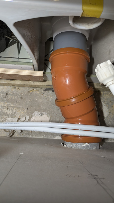

I have a toilet with a boxed in cistern - Outlet is above the level of the soil pipe(~38mm), but also slightly offset (~46mm). There's about 250mm between the outlets. I know the easy answer is 'flexi' but I'm trying everything I can to avoid that.
A Picture:
Today I've tried connecting two 45 degree elbows together, unfortunately the offset was too much. I could try and chain two 40mm McAlpine offset pan connectors together but they look restrictive enough as it is. I'm not willing to buy some '100mm offset pan connector' from Amazon as they may fit, but the restriction is comically small. I really don't want the cistern cupboard filling with poo.
Anyone got any genius solutions? There seem to be multiple options in 'below ground' pipe at shallower angles like this, Is there any reason they can't be used? Google suggests they aren't UV stable, but it;ll be boxed in, so...

The brown pipe is not uv stable as you say. Just means it fades in sunlight. Not an issue for you.
You can also get adjustable bends you can set to any angle. Eg https://www.toolstation.com/adjustable-bend-110mm/p73512

Mcalpine offset pan con plus straight extension tube

Thanks @nickjb confirms what I thought 🙂 I tried one of the adjustable angle roofers but it was too long.
@argee because everyone I've spoken to about them confirms my thoughts that having a load of ridges for turds to cling on to is a generally bad idea, plus the need to support it.
@singletrackmind I couldn't find one with enough offset, and there isn't enough 'give' in the straight one I tried to make up the extra offset.

How about 4 of these and see if the 5 degree misalignment (times 4) can be used to your advantage.  If you can move the toilet pan a bit, connect them all up and then persuade the pan back to it's intended position! https://www.screwfix.com/p/floplast-rigid-straight-connector-white-107mm/17227
This flexible joint might also give you some more movement. https://www.toolstation.com/flexible-connector/p25396

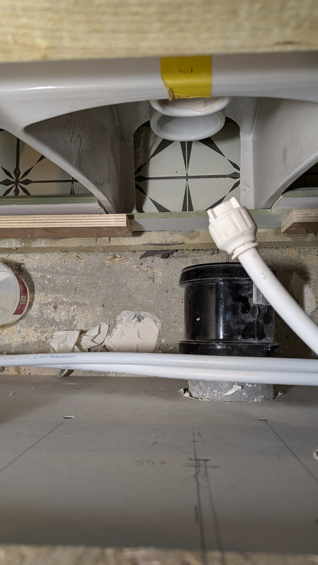

Why do you have a 110 straight soil black connector on the wall .
You can plug a pan con into soil without the swaged end. Give you more room to do it rigid

Good spot @singletrackmind - it was just temporary, it's got a cap in the end to stop unpleasant gases whilst working on the rest of the cupbo... Errr, room.

Is that a pan con in there?
