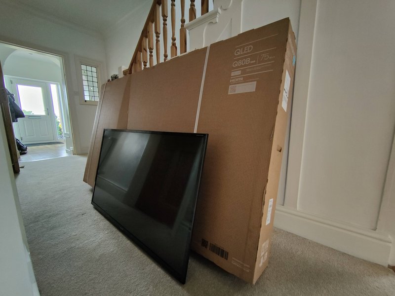

In case anyone was vaguely interested - here's a size comparison with the old 50" set (I realise the box is bigger than the set inside, but still!)

here’s a size comparison with the old 50″ set
I went from a 47" to a 75".
Bought online without seeing the size in a shop.
When I first saw it I thought it was too big, 2 weeks later and it was completely normal.
Could never go back to even a 50".
Looks great with 4k stuff as well.
