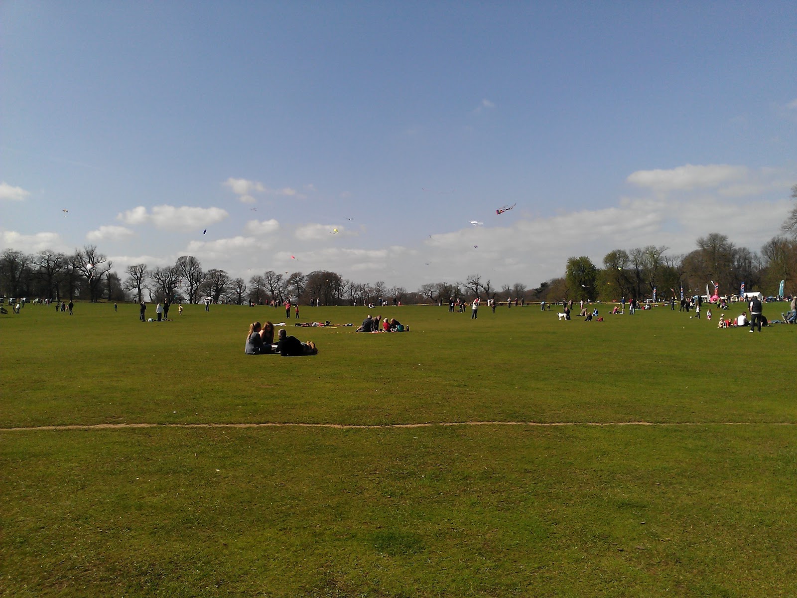

It obviously depends on the soil, how often you drive on it etc, but this field has mesh in it to allow it to function as a car park. Still looks crap after a busy/rainy spell, but it does seem to work.

As my role as a civil engineer I've seen lots of meshes installed with varying degrees of success. The ones that last have a decent foundation installed under the meshes. If you just lay some on topsoil pretty much anything you buy will fail at the first rain.
strips for tyres is the way forward. You will need to take up the topsoil layer though.
