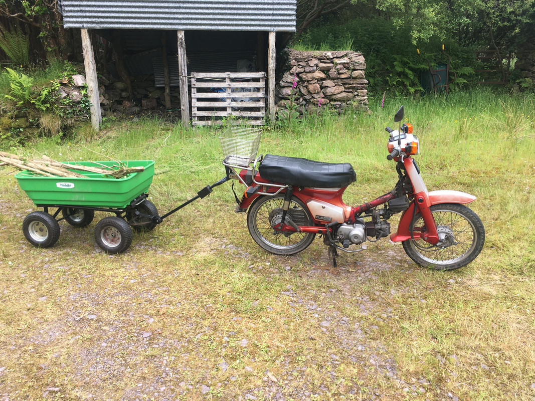

During exhaust removal and with trailer
C90 tractor
In normal state
 90
Posted : 06/07/2021 9:03 am

Tidy (the bike, not the owner, no offence)!
