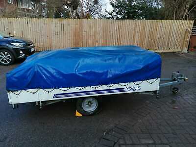

I towed a Conway Mirage with the kitchen unit. 325kg
It’s like this:
Skoda Fabia Estate 1.4 TDI
Didn’t noticed much difference in handling, or driving. Except for being hyper-aware of the width and length especially when making turns. Soon got used to it though.
Posted : 26/11/2021 10:59 pm
