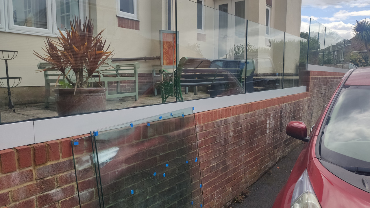

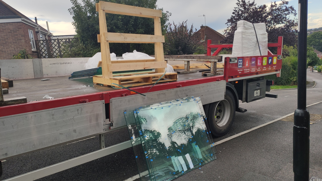

I did that earlier this year, I will try to find some photos. I got my glass from the same company that supplied the mounting brackets, F H Brundle in Southampton. Each panel was made to order.
Make sure you get them to deliver and unload as they are heavy and difficult to unload. We had one pallet of glass panels collapse off the side of the truck and fall to the floor. Amazingly there were only a few chips on the edges where they hit the granite kerb stones from over a metre.
One panel came so close to properly hitting me as it fell over that it knocked my glasses off my nose. Luckily it was just broken glasses and the skin taken off the end of my nose but millimetres close and I would have been using my forehead to stop 200KG of glass sheets from hitting the ground.

Photo shows it was concrete, not granite, kerb stones. Clearly my mind was on other things.
They replaced all the glass but left us the ones that weren't too damaged as I thought I might be able to use them. Now stuck down in the garden waiting for a shed to grow around them.
