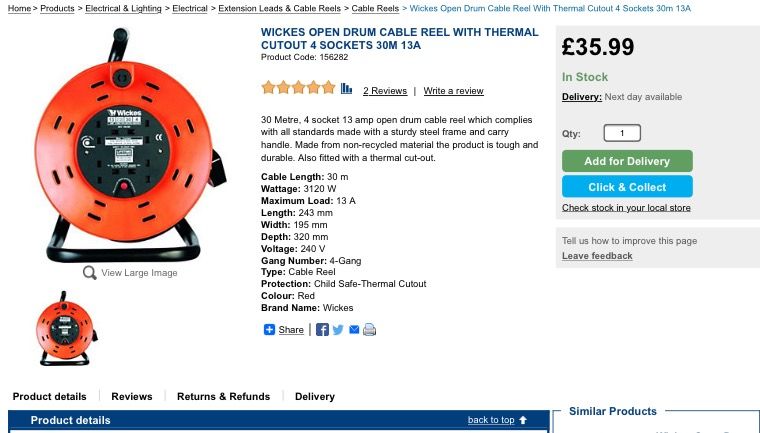

Currently I run an extension lead like the one pictured to an outdoor waterproof plug to power a radio and 2 fluorescent strips as and when I need it.
Now we've had the patio laid and conduit under the slabs I'm just waiting for the shed to be wired properly. I would like in the meantime to plug in my extension lead run it through the conduit and into the shed. Once the cable is in the shed I'd like to have some sort of inline switch so I can just turn it all on rather than plugging everything in.
So , can I do it,what do I need and will I die?

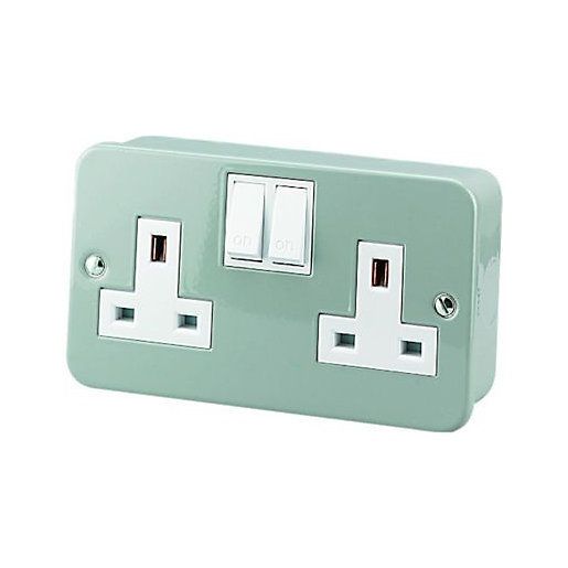

Is this advisable?
I cut the cable a metre from the 4 sockets ,put a plug on it ,then wired the socket pictured to the remaining length of cable and simply plugged it in. The socket would be screwed to the side of my workbench.

Well effectively you're creating an 8 bar extension lead which is then plugged into another extension lead. For starters I would never piggy back extension leads.
It's certainly not 17th edition 🙂
Posted : 30/11/2015 3:02 pm
Posts: 16346
If you mean turning that socket into and extension lead using the existing lead (which is how I'm reading it) then yes, that would be one way. I'd run an extra earth inside the socket to the housing rather than rely on the screws. Also it needs to be plugged into an RCD protected circuit and a suitable fuse fitted.
Posted : 30/11/2015 3:03 pm
I wouldn't be running light and sockets on the same fused spur!
Where will it be connected in the house? it needs to be RCD protected
Posted : 30/11/2015 4:59 pm
The Regs only cover permanent wiring, you can plug as many extension leads into each other as you like. Not that you'd necessarily recommend it, but assuming they're all properly fused, the risk is pretty minimal.
