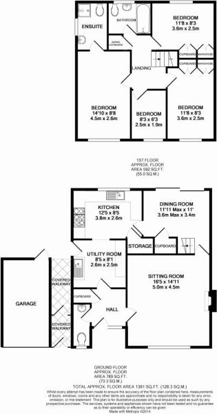

The plan of leaving the kitchen until last in the great house refit has been changed due to the recent condemning of our 1980's range style oven/hob by the gas board. Apparently, letting gas out of the hob jets even while they're turned off is a bad thing (it's 'elf and safety goorn maaad I tells ya).
So, plan is to get the builders in to widen the doorway from the utility into the kitchen to make it into one big room, and also possibly widen the doorway from the kitchen into the dining room and insert foldy doors so the whole thing could be one big room, but also possible to shut the door to keep cooking smells from drifting up the stairs (which come off the dining room). Naturally, both the walls in question are load bearing...
...and then refit the lot with a shiny new kitchen.
So, anyway, all that is a long way of getting to the point of:
1) Just how tricky/expensive is making bigger holes in load bearing wall likely to be?
2) which kitchens bought in trade type places (like Howdens, Wickes etc) do you Kitchen Fitter types recommend? What about *shudder* Ikea?
3) Any recomendations for someone to do the job in Cirencester?

Opening up between the kitchen and utility looks to be good a good plan but you'll still end up with nibs projecting inward, you can minimise this by using steel stanchions instead of block (which could be anything up too 600mm!). You may also need to dig additional pads to do this as the foundations will probably not support it. opening up a bit could probably done with catnic but depends on the load above. Cost wise, steel isnt too expensive but the physical work will be quite bit and the mess will be significant. You'll definitely need a structural engineer to be on the safe side and they quite often will be able to guide you as to the differing approaches. Im not a builder but last year I had pretty much the entire lower half of the gable end removed and supported on steel and using stanchions was definitely the best way for us.

I'd guess at £2.5k for knocking the wall through and making good. Very messy job, but pretty straightforward. You're unlikely to have flush walls at the end unless the end walls are very sturdy.

[i]You're unlikely to have flush walls at the end unless the end walls are very sturdy[/i]
Probably not an issue; a small nib by the back door isn't the end of the world, and the other end can be supported by two other walls (doesn't really show on the floorplan) so may be able to go flush back anyway
