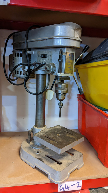

Can sometimes be in for a surprise with eBay / gumtree ads buying on the basis of a photo. A friend bought something that, based on a photo very much like that gumtree ad, looked a 'bench drill' shown with very little contaxt. Went to collect it... it was an extremely burly 6ft tall floor standing pillar drill. The motor was so big and the column so thick that proportionally it looked like a smalll bench top one. Weighted over a ton 🙂

I have had a small bench top drill (similar to the one posted on gumtree) I got from Machine Mart about 20 years ago, its nothing special but for banging holes in aluminium and steel its an order of magnitude better than a hand drill. I am lazy at changing the belts though, so the Bosch would be good on that front, though would have to be convinced the torque was there using large bits or hole saws.
If I want to make holes with any precision I now have a mill so will drill and ream them.

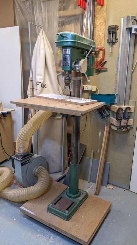

We have this floor standing Multico which is dead handy when you need tall clearance.
It's not mine, I just share it and don't really enjoy the sketchy bodged handles.
Then I have this nice old bench-mounted one by Continental International which is nice and heavy. Rarely use it though.
No recommendations sorry, just joining in with the pillar drill love-in/show and tell.

They go in this…
Nice! Is that a Scorpion?
Posted : 30/12/2021 3:53 pm
CZ - close but not quite! Its a Sabre. They started life as Scorpions, but when the Scorpion and Fox armoured car were retired at the same time (late 90's), they mated the Fox turret to the Scorpion to create the Sabre, very similar to a Scimitar. They were never terribly successful and were sold off after a relatively short period of time, which is how I came to acquire one.
After 40 years of squaddie maintenance, there's plenty to keep my bench drill busy! 😄

Mine is now sat on the new wooden stand I built for it. I haven't actually used it yet but it is nice and big and heavy looking like a proper bit of workshop kit.
