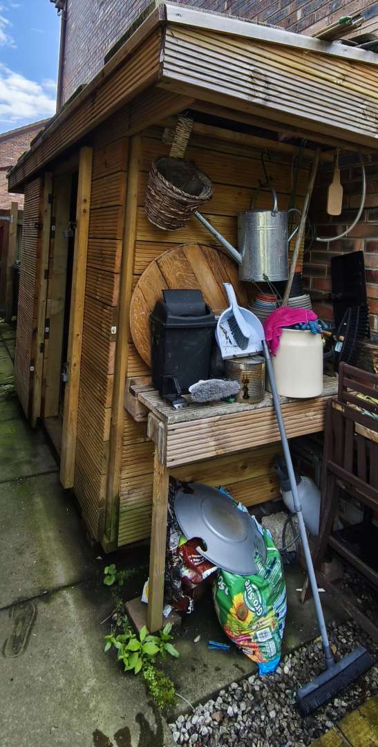

Posts: 2010
I built a wooden pent roof shed a few years ago. 100mm fence posts for corners, 93/38mm treated timber framing for the walls, 25mm thick decking for the cladding, 2 pallets for the base, big roof overhang at each end and a smaller one along the long edge and a large sliding barn door along the long edge.
Decking boards have an expansion gap between them, air breezes through the shed. Overhangs provide sheltered external space for folding garden chairs to be hung up and plant pots.
Internal shelving is at both ends and accessible via the sliding door. Old shed had a door on the end which wasn't very good for access.
 shed is raised off the ground on paving blocks and apart from the roof remains externally reasonably dry when raining because of the overhangs.
I reckon I could easily extend it if required.
i reckon it'll last a few decades or be repurposed into something else if an extension is built at the side of the house.
