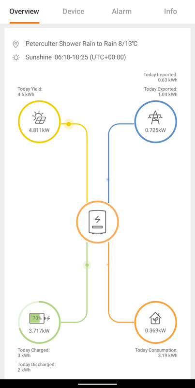

Can anyone suggest why my battery charging rate might be topping out at 3.8kW when the system is rated to 5kW on the DC side for charge and discharge?
Posted : 02/03/2023 1:10 pm
There will be two different limits - what the inverter can push into the batteries and the max load the battery pack can accept. Eg We have the same system as a neighbour but we have two battery modules and he has one. The same inverter can charge ours at twice the rate as his ie the battery pack is the limiting factor in this case.
Posted : 02/03/2023 1:22 pm
Posts: 10509
I know each battery can accept at least 4kW as I've seen it do it, but somehow, now the splitter is in place, it seems to be hitting some kind of limit.
My initial thought was resistance in the cables, but I'm not sure that makes sense. The cable run to Bat 1 (12kW) is 2.5m, to Bat 2 (7kW) is 4m. Originally, the cables to Bat 1 were just over 1.25m... BUT, whilst the run to the splitter is now 2.2m, the power after the splitter is much lower...The cables are the right 100-120A spec.

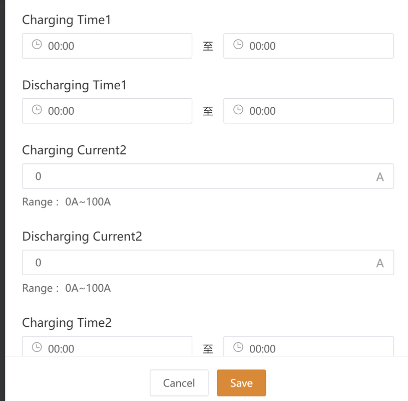

Posts: 10509
I'm still a little wary of forced charge and discharge as they will significantly increase wear on the batteries and some battery manufacturers specifically state that their warranty does not include continuous grid charging.
Posted : 31/03/2023 9:36 am
Posts: 10509
My batteries and the RESU Plus are on the very latest firmware. The batteries individually will charge at 5/5 (98>100A) for the RESU 12 and 4.2/4.2 for the RESU6.5. This has been tested. The problem for some reason is with the RESU Plus or the Inverter>RESU plus interface. We've had several days now where the external temperature has been in the teens and it's made no difference.
I kinda assumed that since the Inverter will only output 100A or 5kW, that each battery would then charge as a percentage of that output and since the bigger battery is essentially twice the size, it would get 2/3rds and the smaller one, 1/3rd. Certainly when charging, unless the gain is VERY low, they both charge and then discharge together. Hence, even though the smaller battery has a lower max charge/discharge rate, in the combined system, it wouldn't matter as it would never actually use peak charge or discharge rates.

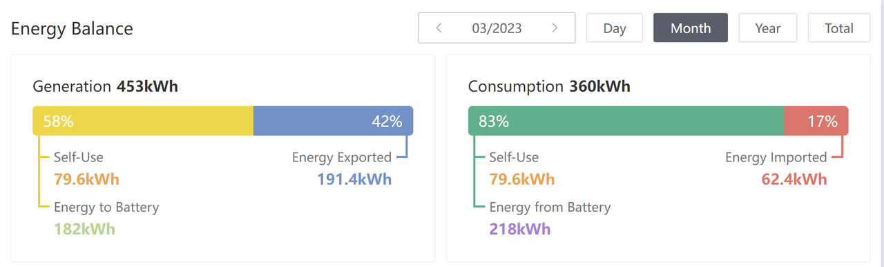

322kwh here compared to 460kwh in 2022.
114kwh exported mostly as we only had one battery till about the 10th and my firmware was updated.
Imported 120kwh

132 kwh imported from grid
so 304 @ 59p = £179 saved this month. Looks like there is a potential saving of well over £2K over the year.

Posts: 7840
358kW from our 5.6kW array in March. Had a Raspberry Pi issue whilst we were away so lost almost 3 days of readings plus had snow cover for almost 2 days so final "recorded" result was 358kW, without the Pi dropout probably around 390kw, thats off 5.6kW array.
March
@daffy
Our manufacturer recommends force charging to 100% regularly as this keeps the batteries in best condition. General consensus from those on the vendor facebook page (many of whom seem well informed) is to set the minimum SOC at 10%, force charge occasionally to max then let the BMS do its thing.
In my view when you consider the battery charge is constantly on/off during the day (possibly 00's of times) as the battery use against solar gain constantly changes then I think this must be the greatest risk to battery longevity. Anyway will be interesting to see how this pans out over the next few years across all manufacturers.
I have changed my overnight charging schedule and reduced it to 45 mins. (8.7kW battery and 5kW inverter) previously I aimed to have 100% when our Eco7 finished at 7:30 and some days I was feeding back more than we were using (only 1p difference in cost) but if I charge and wake up to 50%, even with the early morning kettle and toaster etc it can easily be 100% by late morning and only drawing around 300w so at some point it is fully charged well before the teatime rush.
This is 9am
Posted : 01/04/2023 8:58 am

Posts: 13722
. I’d held off moving as our batteries dont have the facility to force discharge (do any?)
I can control charge and discharge times from Puredrive Batteries via the solis inverter app.
Posted : 05/04/2023 4:19 pm

@bruneep which solis app is that one?
Is it Solis Cloud? It looks different to the UI have for the same functionality (Also Puredrive batteries)
Posted : 05/04/2023 5:33 pm
Posts: 39347
@mickyfinn
That's the web UI on Solis cloud I believe.
Or at least it's the same as Solis cloud.
My app UI is horrific
Posted : 05/04/2023 5:55 pm
mickyfinn reacted
Posts: 13722
1st was cloud app, this is mobile app.
I don't think its that bad 😉 need to get remote access from solis via their customer support
Posted : 05/04/2023 6:03 pm
mickyfinn reacted
Ah right that make sense I never use the actual web app just the mobile app. I should It’s looks nicer 😁
Posted : 05/04/2023 6:58 pm

Posts: 13722
Yes,  set the times you want it to discharge and the discharge rate can be set up to 100A
Posted : 06/04/2023 8:12 am
