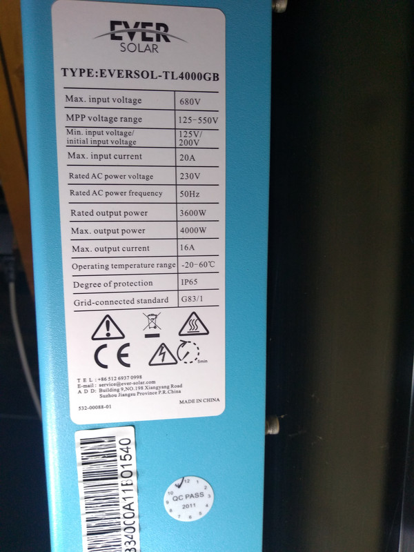

Moved into a house with solar panels on and have some questions if any one can help please? Owners left no details about the panels and invert but did transfer the FIT.
How do I calculate the size of the array we have? Will it say somewhere on the panels?
On the invert display it has a load random things which I have found some by Googling but not all any ideas/check my workings.
VAC = AC current of the main line
PAC = live output of the solar
IAC = ?? (Showing 2.6a)
IPV = ?? (Showing 2.1a)
VPV = ?? (Showing 378.5v)
E-total = ?? (I assume is what it has ever produced)
E-today = ?? (Today's generation total)
Thanks
Posted : 07/10/2022 5:15 pm
Posts: 494
Have a look at the inverter label/type. There should be a spec on it.
Posted : 07/10/2022 7:27 pm
Posts: 39347
Without going up on roof and looking at the stickers if still there on the back of panels.....
The inverter will have a label on. It's unlikely your panels will be much less than that as the bigger the inverter the higher the start up current required.

Posts: 228
Very interesting about the old Vs new inverts I assume this has been in since the original install back in Dec 2011
This is what's on the Inverter.
https://i.postimg.cc/J0c99CLz/IMG-20221007-163439386.jpg
Posted : 07/10/2022 8:28 pm
Posts: 13761
At a guess you've got a standard 3.6kWp (or is it 3.7?) system there.
If it's that old don't touch it until it breaks as you're not allowed to make changes without losing your {substantial} FIT payments.

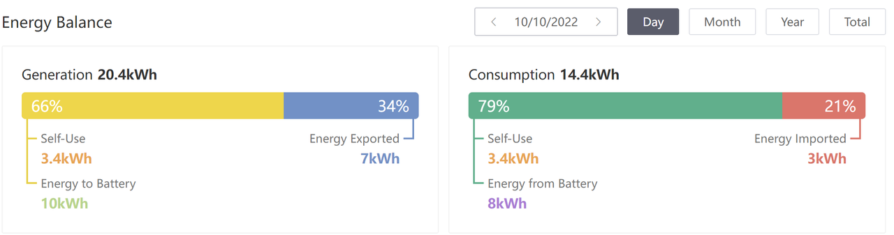

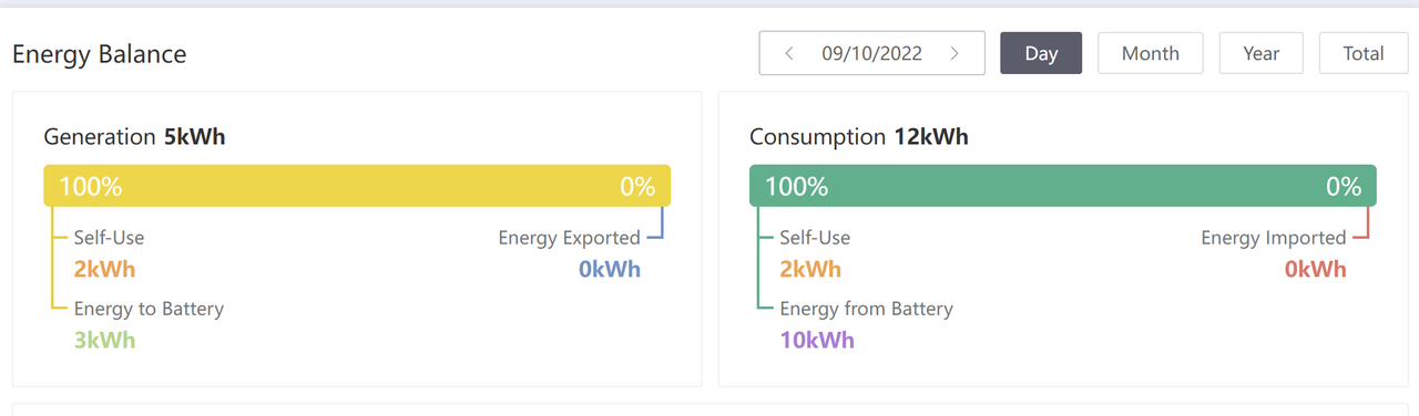

Posts: 118
I thought I'd put this on this thread but it must have been on another one so (and please forgive me if I am repeating myself).

Just remember the bigger the inverter the bigger the start up current required from the panels.
I went from an old gen 3.6 to a current gen hybrid and I generate at much lower light level.

I think the battery is the real game changer for our system. The panels worked for a week or so before the battery did; looking at our usage over that time you can see it made a difference, but we just didn't really need much electricity while they were generating. Once the washer's been on a couple of times that's pretty much it. It maybe knocked 1kwh off our normal 6-7kwh daily total.
Once the battery was in though our import dropped like a very heavy stone, from about 5-7kwh a day to about 0.5kwh. We're lucky in that it's been a sunny October so far but it's covered all our usage as we can save it up and use it in the evening when we use most power but imported power is at its dirtiest. The only time we have needed to import anything has been when the load exceeds the maximum the battery can supply. When winter hits properly we'll fill the battery with off-peak electricity instead, which can be much cleaner than peak time electricity.
