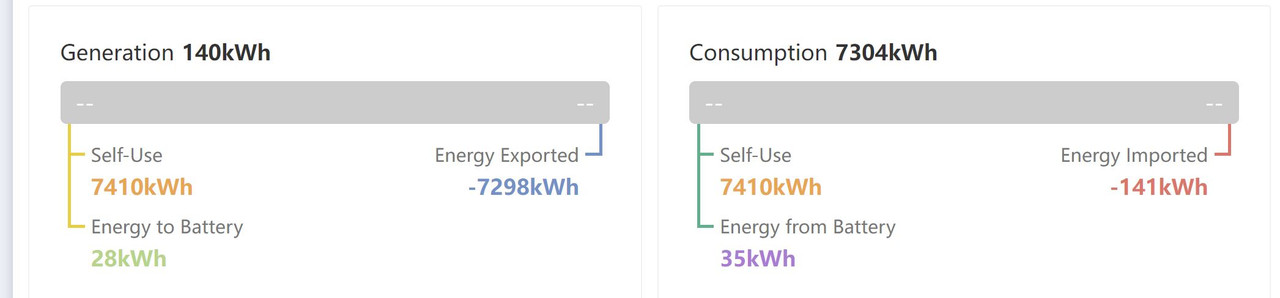

Posts: 13722
Aberdeen, despite the gloom merchants the sun does shine here on south facing roof 😎
5.3kw array
3.6kw inverter
1 5kw battery had 2 fitted one is faulty awaiting a replacement.
What's not making sense to you?
My bills are making sense just now
Yesterday
Posted : 15/09/2022 9:37 am
Posts: 10509
because your original image showed ~7400kWh of use...
Posted : 15/09/2022 9:49 am
Posts: 13761
because your original image showed ~7400kWh of use…
.... and 140kWh generation in what,8 days?
This the the generation from my 3.9kWh system for the last 3 full weeks:
2022-36 67.600kWh 05/09/22 - 11/09/22
2022-35 85.800kWh 29/08/22 - 04/09/22
2022-34 81.600kWh 22/08/22 - 28/08/22
I'm much further south (Chester) and haven't had a weekly generation over 130kWh this year (early August) - so your 140kWh further north in mid September sounds rather "amazing".
Edit: And my system here produced 6.9kWh on the 14th and my 3kWh system in N Wales produced 6.4kWh - yours apparently produced 15!!
Posted : 15/09/2022 9:59 am
Posts: 13722
There are 14 x 395 JA panels on roof
my daily import from grid is around 2kwh a day now,
so on day of install the inverter consumption was started at 7382.1kWh rather than zero there is the issue of funny numbers
Posted : 15/09/2022 10:15 am
Posts: 13761
.... but it's still a 3.9Kwh inverter - that's the maximum it can ever output.
(All standard PV systems in the UK are limited to >4kW output - anything over that requires permission from the local DNO)
I might be wrong, but the generation just looks huge!
Posted : 15/09/2022 10:27 am

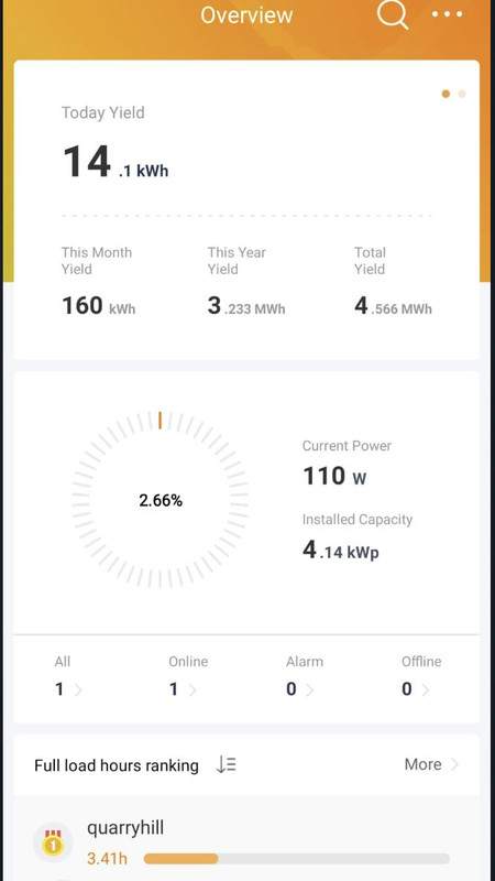

Posts: 7864
Many hybrid inverters include power drawn from the battery in their “generation” figures. You need to dig a little deeper into the stats to get the actual solar generation total or use something like Home Assistant.
I have 12 JA 395W panels split east/west in North Yorkshire and over the last week they’ve generated between 5kW (rainy day) and 15kW (mostly sunny).
Having to do everything from the website annoyed me so I’ve built an in-home display similar to that you’d get with a smart meter which shows stuff in real time (3D printed case still printing)
So-lah
Posted : 15/09/2022 10:46 am

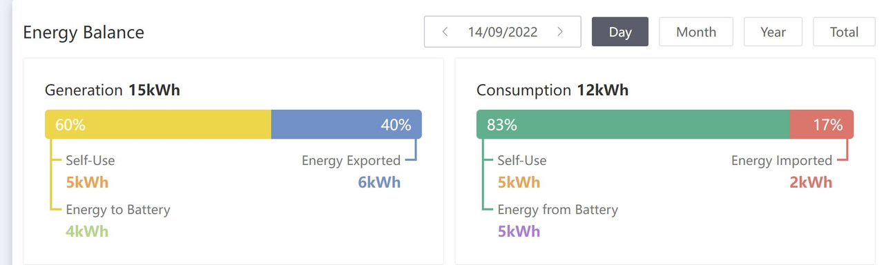

Posts: 4156
I'm in Warrington, about midway between trail-rat and sharkbait. On 14 September my main array (2.15kWp) generated 5.1kWh; so that's about 2.4kWh/kWp (or just 2.4h/p?). The 15kWh bruneep made would be 3.8h/p (if inverter limited), which is much better, but East coasts are often sunnier than West coasts.
Posted : 15/09/2022 2:43 pm

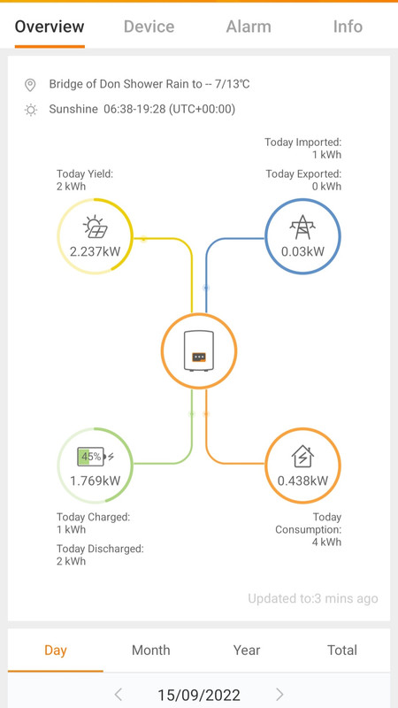

Posts: 783
Interesting seeing everyone else's app readings for comparison to my system (still cant master the forum posting images thingy so cant show mine) but its very much entertaining my inner Nerd 🙂
Day 2 of my system running and the battery was at about 11% first thing. It was overcast for the start of the day but the solar panels have been working well and the battery was fully recharged by about 2:30pm.
My small-moderate-ish 10 panel system has yielded (is that right?) about 8kWh aginst a consumption of 6kWh (again, not sure if im reading things right...) so far today, the bit im so far intersted in is the generation/use vs what needs to be imported which is currently 67% from the system/battery against 33% from the grid. Thats pretty much what the survey estimated the system would give me on a normal day for the south coast so I'm pretty happy so far.
I need to let things run for a few weeks, sort out when to run the dishwasher and washing machine so it can use as much solar as poss (we tend to run the dishwasher late at night). SEG definatley needs to be sorted as the energy being exported to grid is not being paid for (will check Octopus for this) and the second battery will probably be added in the Spring when funds allow.
Posted : 15/09/2022 6:49 pm
Posts: 4156
@bruneep  Your graph appears to me to show that you were, at times, exporting 4kW. How is that possible with a 3.6kW inverter? I'm not saying you're wrong, I just don't understand.
Posted : 15/09/2022 7:02 pm

Posts: 494
^his export totals for the day are 8kwh, so about 2.5 hours worth of production if you look at it that way. Fwiw I can back up his figures as I’ve a similar set up. 12x385W JA Solar panels & 3.65kw inverter and getting similar daily figures (if not slightly less due to a. Less panels and b. Living in Glasgow).
Edit-ah yes, sorry just checked the graph, does seem a tad high given the inverter rating!
Posted : 16/09/2022 2:16 pm

Posts: 13761
I'm wondering if the figures being produced are for the power being generated by the panels - not what is actually sent out of the inverter.
If so that's a little bit crafty (you could have a load of panels producing, say, 7Kw but you'd still only get 3.6kW to use)
