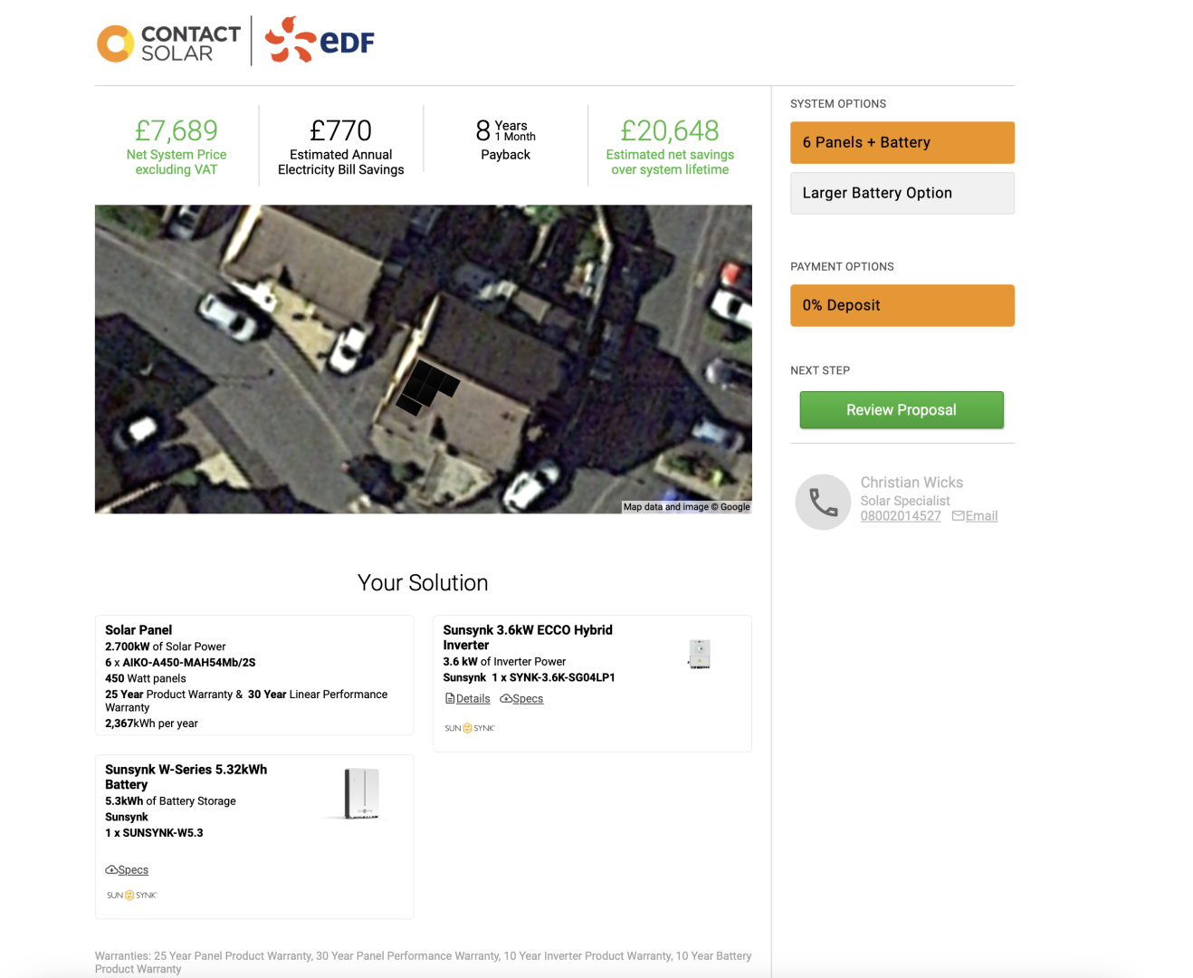

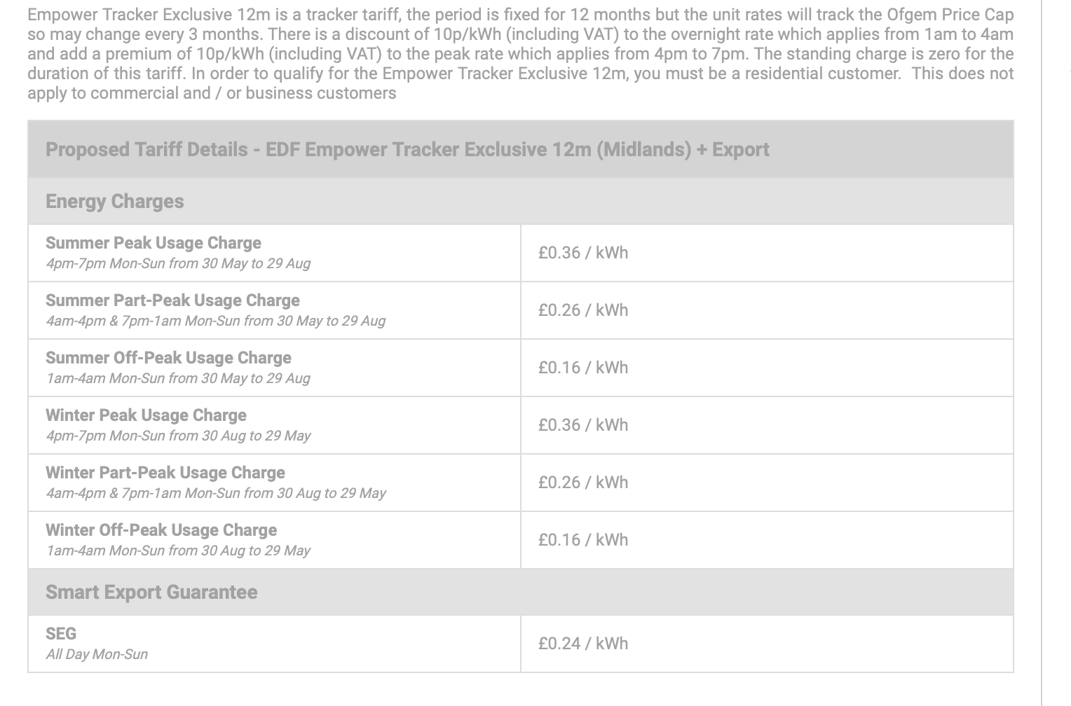

Posts: 5140
Anyone care to comment on this? It's a scheme offered by EDF.

Why only 6 panels? The panels are relatively cheap and if they are there with scaffold and doing all the wiring etc may as well do more if you can. 19 panels were fitted in basically a long day by one electrician and one roofer. Panels had to go on day 2 as it was too breezy on the first day but all the rails were fitted. Peak rate for usage is quite high and you won't be generating much at that time of day. Speak to the guys at Skylar Solar, they were very good for our system and have a good reputation.
Posted : 06/06/2025 2:51 pm
Posts: 1653
yer fill that roof, it's madness not to
Posted : 06/06/2025 3:07 pm

Why only 6 panels?
Guessing that's all the front of house roof will fit looking at satellite image. What's your daily kwh usage?  I'd increase the  battery storage if you have space to, I had 10kwh battery storage, my daily in autumn/winter is just over 10kwh, recently I added another 5kwh this gives me a bigger range of stored power.
Once you have solar/battery this opens up access to cheaper rate electric to store up battery at night, useful in winter months when not generating much if any. Also get a seg account set up to get paid for and unused generation
My export payment for last 3 months was £264, thats just green export. Seen many boasting about their brown exporting ££££ I'm guessing it won't be long before there is a clamp down on that. Buy at 7p sell for 16.5p....

Posts: 7790
Posted by: bruneep
This is what our tariff deliberately offers. Import and charge when grid demand is lower so it can be export at high demand. All controlled by the supplier.
Posted : 06/06/2025 3:51 pm
Posts: 13722
Posted by: nixie
That's a completely different set up when the utilities co are controlling your set up, why you grant them access is beyond me but not something I'd allow.
Posted : 06/06/2025 4:05 pm
Posts: 15862
If the utility knows when it can access your battery for export then it becomes dispatchable and is worth more to them. Which is why they can in turn offer the consumer a better rate.
Posted : 06/06/2025 4:13 pm
Posts: 7790
Posted by: bruneep
It's a trade off isn't it. I'd rather have the control but on present evidence giving the control will reduce our bills. Can revoke access at any time I please.
Posted : 06/06/2025 5:31 pm
Posts: 5140
Posted by: chowsh
Why only 6 panels?
It's a guesstimate of what will fit based on the satellite image.
Posted by: bruneep
There's an option for a second battery, bumps the cost up to £9k.
Posted : 06/06/2025 7:39 pm
Posts: 188
I’d at least look at the bigger battery option or at least how easy it is to upgrade it and whether you’ll need a bigger inverter. The signergy kit Sklyar install has modular batteries where you can just add another to the stack and tell the system with no rewiring etc. Since we got our export sorted this month we have run the house off the overnight EV cheap rate topping up the batteries and exporting the excess solar during the day.
Posted : 07/06/2025 11:05 am
