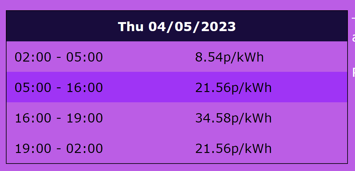

We're on a dynamic tariff - Octopus Agile.
I've just set ours up to do a partial charge between 3 and 5 am, if the battery is below 60% and if not, do nothing. It hasn't charged now since the start of the April, but prior to that it would top up after overcast days, so we always had enough to get past peak hours (5pm-7pm) every day on the battery.
Initially I did use to look at the rates every day, but lost interest after a while.

Flux has really changed the economics of solar/storage/thermal. Before it was almost a given that you should use as much power as possible, now it’s practically even to simply export/import unless at peak times
Given we have many wet dank days with poor solar I can't get this to add up for me, currently on tracker tariff for E&G and 15p export.
Elec tracker is 18.74.
Flux is around the 32p are you relying on export to offset the the higher import over the longer term?
import
export
Posted : 04/05/2023 9:47 am

Posts: 7790
That is the idea. Use battery through the peak period and then hopefully the export will pay for any import when averaged out. Use cheaper period to fill battery in the lean months. I'm not getting paid for export yet which is annoying now we are generating much more than we are using (paperwork apparently).
