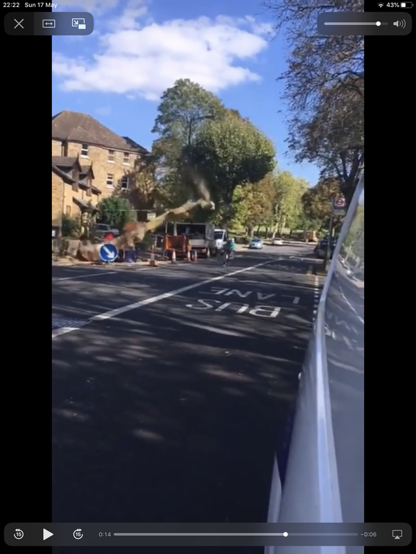

I watched it again frame by frame, and took screen shots of three frames right on the incident.
The cyclist is fractionally in front of the tree by the time it’s at shoulder level, he missed being hit by a fraction of a second!
Lucky barely begins to describe it.
