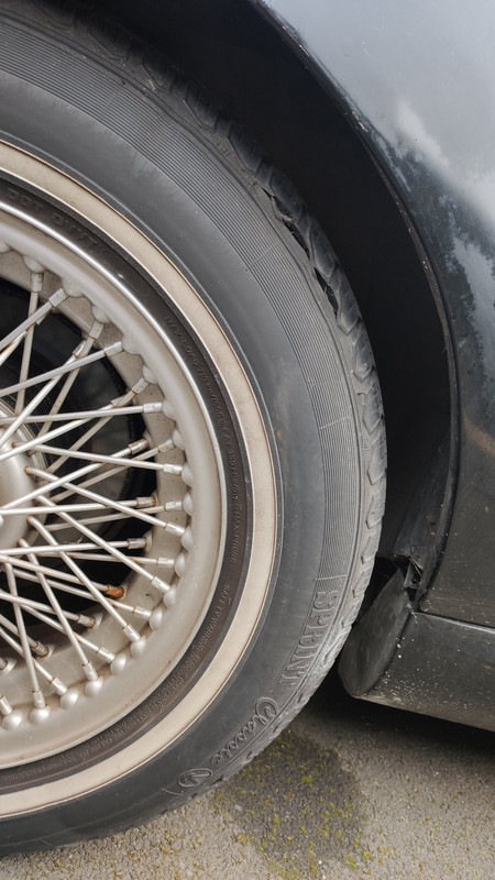

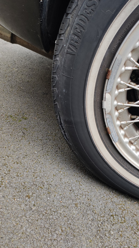

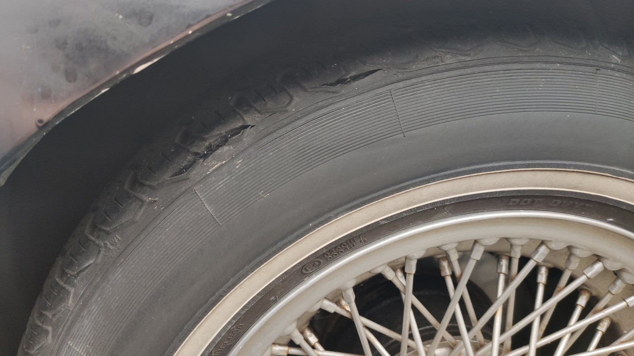

I moved one of the cars for the first time in a while and the brakes were rubbing. I assumed it was just slightly seized brakes from lack of use so to it for an Italian tune up to put some heat in the callipers and free everything up.
When I got back I raised each wheel and spun it to check it was free. All was good until I got to the fourth wheel where I spotted this in three places around the wheel. Re-check the other tyres and they were all perfect including the other car wheel fitted at exactly the same time.
The fact it was in three places suggests not simple tyre damage but proper tyre failure but any suggestions why?

That, my friend, is the rubber perishing due to age! The rubber hardens with exposure to weather and UV, and will start to split, especially along the edge of the tread where it joins the wall. Those need mending with new ones, immediately, if not quicker!
They are downright dangerous, a sudden blowout is highly likely.

I am looking on Vintage Tyres right now for replacements. Seems strange it is just the one and only 4 years old but it spent most of last (sunny) summer parked up with that tyre exposed so maybe.

Whats the date code on the sidewall?
Bet they are quite old and probably past best

Thats a tyre fault - delaminating , lucky you spotted it , more dangerous on the back where you notice it last, on the front you should get a warning via the steering wheel.

TBH it that damage looks like the delamination you used to sometimes get on remoulds back in the day (they don't still do them do they?). As a child I remember a remould my dad had fitted on his old Hillman taking itself apart on the M6, happy days!

Tyres need to be used regularly to last, the flexing keeps them supple. It's made worse with cars that are stored over the winter as the tyre 'sets' in the position it's left in so the bottom is squashed. When they're moved in the spring the rubber can crack immediately, especially if the tyre is old (over 5 years or so). The tyres on my Mini's date code are all 3114, so 7 years old and I'm contemplating changing them even though the rears still have their mould markings and the fronts have less than 1mm worn off them (7mm depth). I'll see how they are after a run to scrub them up a bit as they have no cracks whatsoever right now but even then I'll be paying close attention to them before every use. I think the tyres have been on the car 4 years though as the rims were manufactured in 2017 so they will most likely be changed for next year anyway.
If you're not doing the mileage to wear them out in under 5 years then budget for replacing them around that time, they're a major safety item at the end of the day.

Just checked the tyre date and it is 1612 so they are nearly 9 years old. I was about to get shouty with the tyre place I bought them and found out I bought them early 2013. It was the fronts I replaced in 2017.
High temperatures and lots of UV, then lots of frost and cold during the winter, and sat without moving...
I think that’s your culprit.
