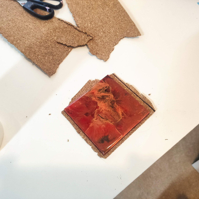

I didn't have any of the Gorilla glue I used last time to glue the cork to the bottom of the coaster. Not an issue I thought, simply use superglue it and put some weight on it to make sure it sticks.
The tile is stuck firmly to the cork. 🙂
The tile and the cork is stuck firmly to the Ikea plastic coated cardboard desk top. 🙁
Any suggestions for removing this without destroying the desk top?

Get some liquid glue dissolver/sticky stuff remover and let it soak in. Lots of different types available.

your challenge is to find a solvent which dissolved the glue substantially quicker than it dissolves the plastic coating on the table. To be honest of things which dissolve cyanoacrylate (superglue) the least aggressive is likely to be acetone - if that destroys the table you are probably ****ed. I'd probably suggest using ordinary nail varnish remover (which is not pure acetone) in the hope its gentle enough on the plastic. Otherwise - is it in a good place for a permanent coaster?

[i]Get some liquid glue dissolver/sticky stuff remover and let it soak in. Lots of different types available.[/i]
I have a little tube of that but not sure I can get it to squeeze underneath the whole tile.

Warm soapy water is supposed to dissolve superglue. The challenge is to get it to penetrate under the impermeable tile. Maybe place warm wet towel over the whole thing, then pick out the cork around the perimeter, and repeat.
Slightly (? - just remembered who I'm advising) more risky is a sharp knife to slice the cork horizontally, so that you can life the tile and attack the cork directly.

Hot water...it'll soften the glue and allow you to lift it...probably sensible to built a wee barricade around it so the hot water doesn't pour everywhere and scald you.

Can you get under the edges at all? If yes, a carbon fibre (as in small teeth to cut CFRP) hacksaw blade will cut the Superglue very efficiently. Cut the pin ends from the blade, tape the table to prevent further damage, heat the mat/cork and gently cut away until it comes off. Then apply some acetone to whatever is left and/or gently sand it. Even with this, you're still likely to have a mark(s) on it.

get some Bob Smith UN-Cure super glue remover or similar and try some on an invisible part of desk to see if it affects the finish.

Dental floss (stay with me...) use it like cheese wire, held flat to the table. Cut the cork off then some nail varnish remover to clean up any residue. Other strong string like substances are available.

Heat the tile with (say) a domestic iron until the glue between it and the cork softens, then prise the tile off.
Scrape cork off the desk & remove the remaining glue with acetone / nail varnish remover.
Posted : 18/11/2021 6:19 pm
Hard to see you’ll get that off without damaging the desktop, but you could just cover it with a vinyl wrap.

If it were me I'd work down through the cork- slice through initially with a pallet knife or similar then nibble the cork away bit by bit. The only saving grace of superglue is that it's brittle so it can often be chipped off a hard surface without harm- though, the cork will add hassle I expect.

Heat, heat releases super glue. I make model steam engines and use that trick all the time.

Err, superglue debonder.
Damages a lot of plastics though.

Slight anti-climax I am afraid.
I used a 4 inch wide razor blade in a paint scraper with a 12" long handle. Slid the razor smoothly along the surface of the desk until it hit the side of the tile and swiftly levered it up. I expected the tile to snap but it just popped up taking a couple of small sections of the desk top plastic with it.
The remaining coasters were left on greaseproof paper while the glue dried and were all fine.
