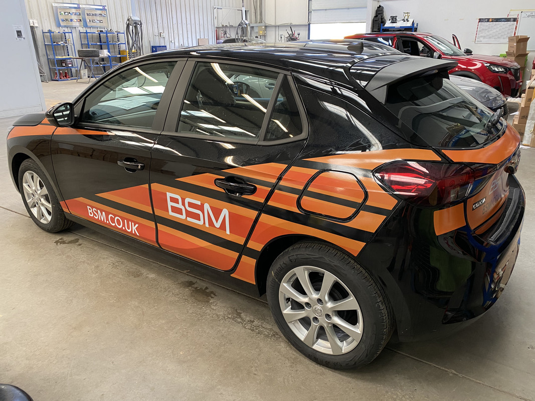

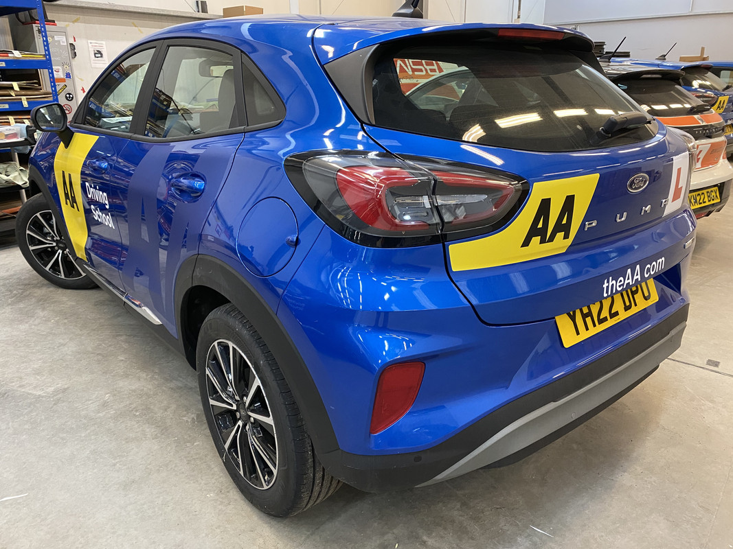

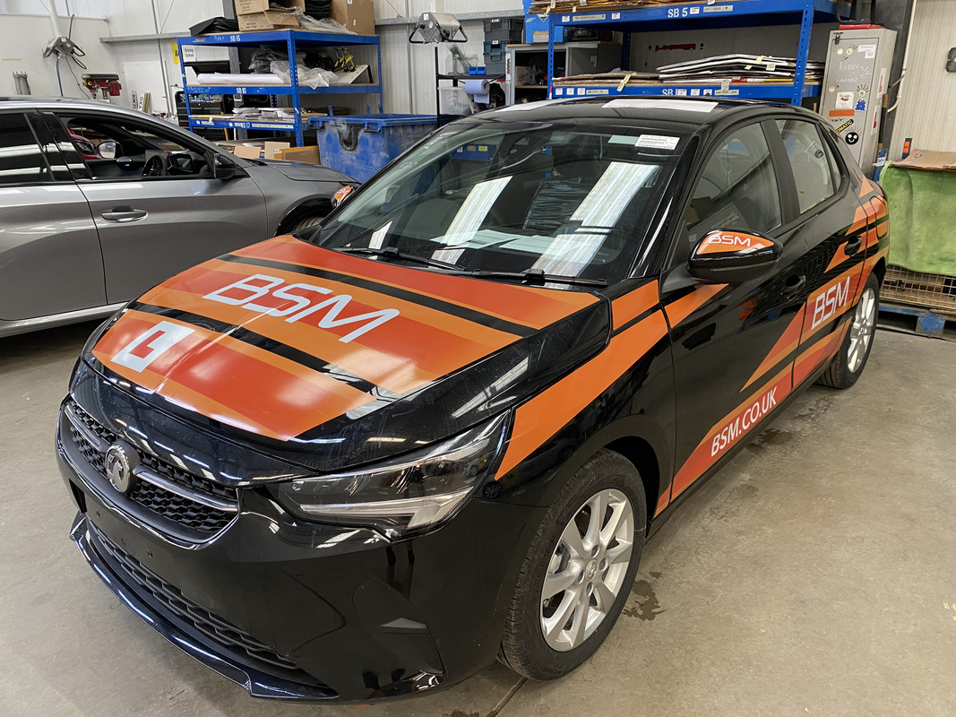

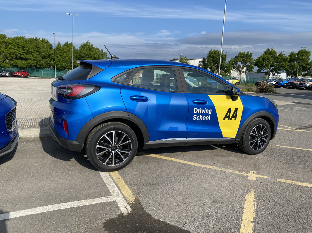

Honestly, don’t even think about it! For the last year my job was applying the vinyl livery decals to driving school cars, specifically AA and BSM cars, and to do one properly, without getting bits of dust, or creases, I would reckon on three a day, maximum, and that’s applying relatively small, pre-cut decals. I was working indoors, the cars were power-washed outside, squeegee’d off, then each area to have a decal wiped over with IPA/isopropyl alcohol, then sprayed with soapy water. Then the decal had half the backing sheet removed, the adhesive side sprayed with the soapy water, carefully turned around and the rest of the backing sheet removed and the rest of the adhesive side sprayed.
Then the decal was offered up to the panel, and moved around carefully to make sure it was centred as well as possible, before starting to squeegee the water and air-bubbles out, using squeegees with a synthetic felt along the edge, then a heat gun was used while getting the air-bubbles out completely. The biggest decal was across the bonnet of a Corsa, and to get the second half of the backing sheet off meant standing on the sheet, while pulling the decal upwards and spraying it. At the end, I was holding the decal as high off the floor as I could, and the bottom corner was barely centimetres from the floor, and I’m about 6’. The slightest dust particles would show up like a large zit, and be difficult to remove, and bubbles the same, needing a needle point to puncture the vinyl while heating it.
The heat guns I used were industrial ones, set at 350°, and melting the vinyl is very easily done, as is burning yourself. It hurts, a lot.
The other thing is, the vinyl doesn’t really last very long, it weathers, it’s affected by UV, and it shrinks quite dramatically - cars would come in sometimes to have a decal replaced, and even after only a few months the decals had shrunk by several millimetres, showing a grubby line around the edge where the adhesive was left behind.
After a year, I was just about confident I was getting reasonably good at doing the job; there is no way I’d ever consider doing a full wrap!
Just don’t.
Oh, btw, we weren’t using air-release vinyl, because the decals were printed on fairly thin vinyl, but the colour layers plus a clear top layer made it pretty thick, and difficult to work around the curves of a car body - certainly, most ‘vans are fairly flat, but you’re going to be dealing with square metres of thin, expensive vinyl, that will flap around and be extremely difficult to manipulate.
It’s also worth mentioning that professionals take off everything, like door mirrors, handles, bumpers etc, so the wrap can be folded around the edges, and windows have to have the vinyl pushed behind the frame, to avoid water creeping underneath and causing it to lift off.
Posted : 21/04/2023 2:46 pm

Here’s a couple of cars I did, the Puma had updated livery, which was simpler, but the AA logo on the rear door was a royal pain to do, because it was two separate pieces, which had to be aligned, and the material was very thin, transparent, with a frosted surface. Very easy to tear, and the tiniest bubble or speck of dust would show.
