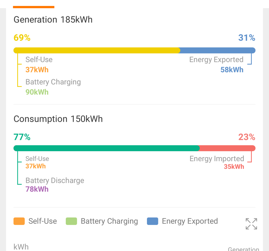

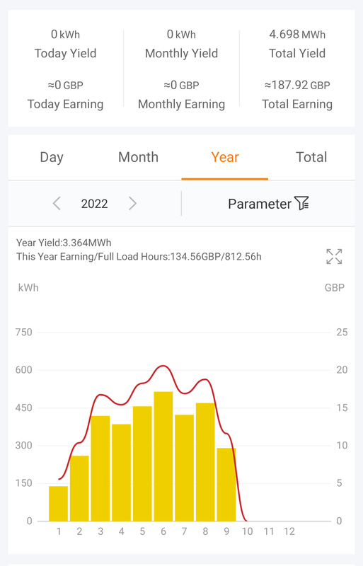

That's my year to date.
Then I got a new inverter (same brand but battery ready ). It seems to give me power generation at lower light levels so I have high hopes for better readings
This is October alone. With the exception of the 4/5th when on the 3rd Mrs tr used the washing machine and tumble drier several times *because we have the battery* and drained it .... The we had 2 rainy dull days back to back we imported 6kw each day. But normally it's 1 or max 2 kw most of it is due to our electric shower. Which is going- going to fit a tank using immersion and probably solar PV
*Edit apparently I'm better at electric than posting pictures on this site...
