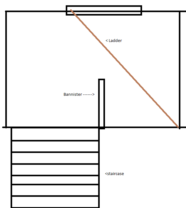

I wasn't aware there was a stair specific ladder available but what I'm looking at doing is something like this: (not to scale)
ladder
Posted : 12/11/2023 7:27 pm

Ahh thank you! so if the angle is more acute than 75 degrees, it's a bit iffy?
The instructions seem to suggest 75 degrees is ideal, so if it was 65 degrees, that would be dangerous? I'll have to measure up properly to see what angles I'm looking at.

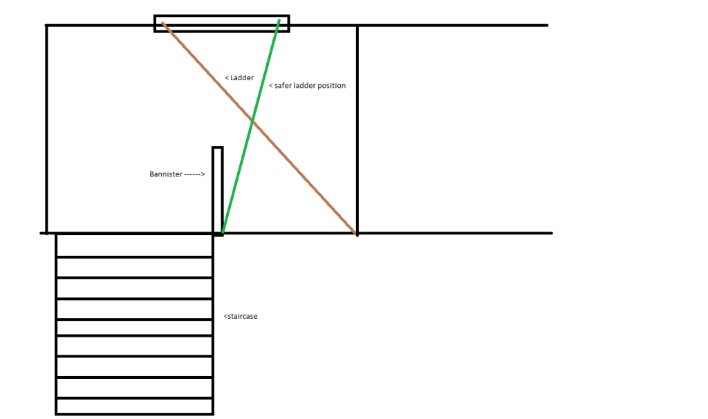

This might be better then, using the bannister as a brace for the bottom of the ladder...it would be more awkward to get on the ladder and its a long drop though!
Untitled
Posted : 12/11/2023 8:08 pm

Tie bottom of red ladder to Bannister to achieve 75° or wedge against wall or screw batten into floor to hold bottom of ladder erc

Ratchet strap the ladder to handrail and use a board to reduce the angle to rest the feet against.
Just like blastit typed lol

Rather than try at 180 degrees (the red and green lines on the image above) can you not turn the ladder through 90 degrees to achieve the correct angle? From the sketch it looks like you've got enough overlap between hatch and landing but appreciate that's not to scale 😉

Bro in law  (PASMA instructor) suggests we all use a ladder app on our phones whenever we put any ladders up. I've been surprised on a few occasions when its complained that the ladders have been too steep or shallow. I've also taken to whacking a rawl eyebolt into any wall we're working against and strapping the ladders down to that. Tying to the Bannister is a good call.
Posted : 14/11/2023 11:33 am

could you put a joist across the corner of the hatch allowing you to rest your ladder diagonally, on an edge which is the correct angle for it (thus reducing the amount of drop, maybe)
