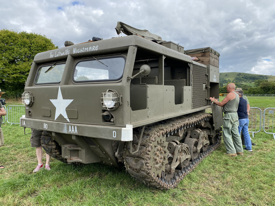

Council turned up about a week ago, couple of blokes tipped some tarmac into a few of the potholes I’d shown on here outside my house, and a bit either side, then pissed off having ignored all the other potholes. It’s getting to the point that something like this is worth serious consideration as a daily driver…
