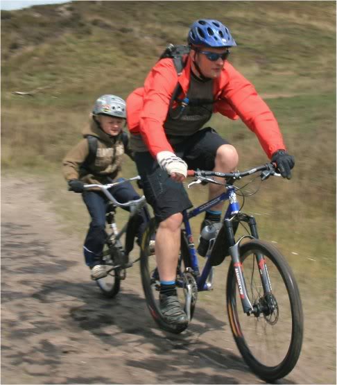

As the inventor of the tagalong races at the Big Bike Bash, I can assure you there's no need for replacement pivots and bushes! Just do it up properly.
Ooh, must be 11-12 years ago - a day in the New Forest (complete with broken hand 😀 )

And seeing as we are doing pics...
[url= https://live.staticflickr.com/2618/3897731264_1f7dfb8a71_c.jp g" target="_blank">https://live.staticflickr.com/2618/3897731264_1f7dfb8a71_c.jp g"/> [/img][/url][url= https://flic.kr/p/6WqTHb ]Glen Ogle, Killin[/url] by [url= https://www.flickr.com/photos/matt_outandabout/ ]Matt Robinson[/url], on Flickr
