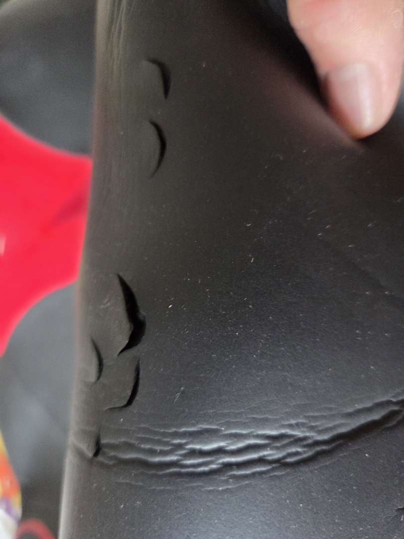

Can I have a sense check here, ordered from Alpkit outlet, 2nd's wetsuit - Ebay description as light wear/ scuffs -
https://ebay.us/m/XnW0W3
Turned up today, on right top of leg are 6 marks, look like finger nails, with the biggest going 90%+ through the material.
I paid £70, so not massively cheaper than new in current sale, am I wrong to expect better quality than this? Bit pissed as not visible in pictures or mentioned in description
I have wetsuit repair glue, but feel these should have been highlighted on description, as probably would have given it a miss with the depth of some of them
Posted : 15/07/2025 11:50 am

So they’ll be glue able, looks like someone has tried it on and made a right hash of it I would say. Up to you. Damage versus saving! If you glue get the black witch neoprene glue. Easy to do
Posted : 15/07/2025 11:57 am

Have some black witch glue already, just annoyed not mentioned in description.  Have since found another on other leg, exactly as I thought, someone pulling it on put nails pretty much through it.

As a life long nail biter, you don't need nails to do that to a suit. I dragged mine out for a swim at the weekend and it's peppered with finger marks like that.
Black Witch on order...
Posted : 15/07/2025 12:41 pm

Firstly, shame they were not on the description - they probably should have done better there. Ex hire suit nearly always are covered in them.
Secondly, marks like those are a reality with swim wetsuits. The super soft unfaced neoprene is very very vulnerable. Nicks like that are almost inevitable with beginners new to swim wetsuits as it does not matter how many times they are warned they think they know better. They once wore a surfing wetsuit and think you are an idiot for making a big deal of it. Add some red mist in their first triathlon they are taking far too seriously and bosh, nail nicks all over it. Top end suits are even worse as they are so fragile. Fortunately most people who have spend £600+ on a suit and done loads of racing have already learnt their lessons but even so I've seen suits shredded in transition.
Those nicks should be repairable fine with black witch. And they are not in a high stretch area so 'probably' will be fine.
Then - some top tips......
1. Cut your finger nails. Like every time you wear it. Ladies with long fingernails basically can't put on a swim wetsuit.
2. Consider gloves to put it on. High end suits often come with white glove like a butler would wear specifically to put the suit on.
3. Assuming its a good tight fit (I see you went for the XL, so likely to be a little large I'd say for a proper tight fit) take your time putting it on. It's not a surf wetsuit. With a high end suit I reckon it would take me 15mins to put it on properly. Gently pulling the neoprene up your legs so the groin is actually up by your nads. Then pulling and teasing the neoprene up around your torso so the spare is around your chest. Then same with your arms so you get enough stretch left in your shoulders to be able to swim naturally. All the time making sure you don't snag the neoprene. And as I said before - if the fit is good, you need another person to do the zip up whilst you stand straight with your shoulder blades pulled together so it's possible to do up the zip without ripper the suit.
All the above - you remember I said I don't bother anymore? That's why! The suit you have is relatively basic, cheap and robust in comparison to many, so you don't need to be crippled by anxiety of the process like you would with one three times more fragile and ten times more expensive, but you still need to treat it with a bit more respect than you are probably used to as ably evidenced by the nicks you have inherited.
Posted : 15/07/2025 12:42 pm

Yeah, I am bit more rational now have had food/ time to think. As said, I am more peeved it wasn't mentioned or shown in listing, on closer examination most are nearly through back of fabric, and is another on left leg.
I naively assumed buying a 2nd from the manufacturer would not mean in need of immediate repair! I wasn't fussed about the mark from a sticker in above these - just feel they haven't been transparent. Have pinged them a message on ebay, will see what they say when they are back at work tomorrow. Clearly it is cheap, and I probably can/ should use this as a cheap experiment in swim wetsuits.
I've repaired my surf suit with black Witch before after the fin gouged it, and was expecting to need to be careful with this - just annoying to be repairing someone else's damage I didn't know I was inheriting.
