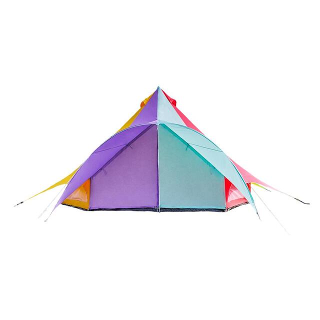

Posts: 2826
Decathlon, just for the colours
t

Anyone that’s gone down the Canvas route, any comments on Canvas “GSM” weight?
Grammes per square metre? No idea, but quite a lot of modern 'canvas' is actually Polycotton, so faster drying than full-on 100% cotton - how much faster depends on the percentage that's polyester.
We has the loan of a nine-person Tenttipi teepee for a few months and it was ace as a summer camping experience - apart from the bit where my mates tried to set fire to it using the firebox while I was out on a lap at Mountain Mayhem. Drying it was a pain the backside though, partly tbf because it was quite large. Generally the easiest way to dry tents is to pitch them something dry and windy for an hour or two, but with big tents that's not always easy so you end up draping them over washing lines / bikes / whatever.
Alpkit does a bell tent btw, sometimes on sale:
https://alpkit.com/products/roundhouse?variant=32518434259049
Posted : 29/01/2025 2:07 pm
