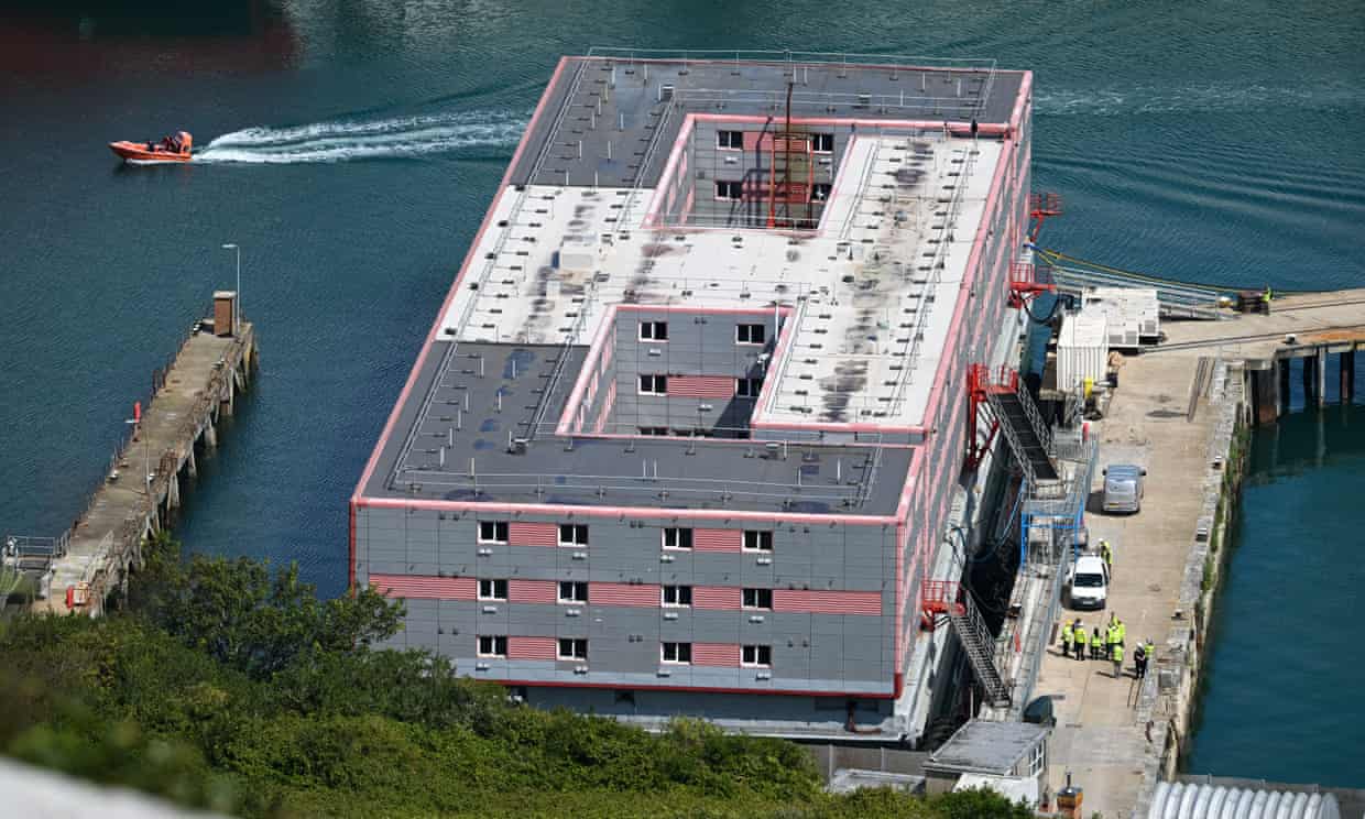

Whereas the times / guardian reports seem to imply its much more serious.
I guess a part of the issue is that when its construction workers on board you can assume that they are trained in how to respond in the event of a fire and are all able to understand instructions.  When its refugees this assumption cannot be made and thus the risk assessment is altered hugely.  YOu would need far more fire marshalls to ensure safe evacuation for example

Some of the the language used in that Guardian article is nonsense. Comparing it to Grenfell is just nonsense.
It is not made of flammable material.
It's not 24 stories high.
The occupants will not be instructed to stay put and the photo shows it has 3 gangways, 1 for each level.
The internal stairwells will have fire protected doors and there will be sprinklers in every space.
The risk assessment issues, I guess will be as TJ highlighted, down to evacuating untrained non-marine personnel safely and quickly. A basic induction and regular fire drills should cover it.
The real scandal here is the cost and the nature of the non-competitive contract award. That barge is now earning more money than it ever has before and ever will doing it's dayjob.

Need to be pretty thorough.
Not really. "Hear this noise and go this way".
How is it worse than a hotel?
It will have much better fire division and fire suppression systems.
It has multiple exits, 1 on each level of accommodation.
However, I will say again, this is a ****ing stupid idea and makes no sense but safety is a bit of a red herring.

"It has multiple exits, 1 on each level of accommodation."
If this was bricks and mortar building a single exit per level wouldn't be accepted given the number of units/occupants, travel distances.
Is it known that they're is smoke control, sprinklers fitted?
You can compare it to Grenfell as that was systematic failure by multiple agencies, much like this could be.....

If this was bricks and mortar building a single exit per level wouldn’t be accepted given the number of units/occupants, travel distances.
What buildings have an exit to the outside on every level???
This thing will have multiple stairwells connecting the levels internally.
Is it known that they’re is smoke control, sprinklers fitted?
Will have fire dampers in the ventilation, fire screen doors in alleyways and stairwells. Sprinklers in every space and CO2 flooding in machinery spaces.
These things are designed to be operated offshore, you don't have the option of walking out the door if there's a fire, so the level of protection is much higher than a building ashore.

Blocks of flats over three storey with more than 4 units per floor
you'd have two exits per floor to protecte routes that would lead to a place of safety i.e. the external air.
Unless you have personal experience of the accommodation in question everything else you say is supposition and speculation imo, it's not like the Government has a record for using best practice is it?
I don't need personal experience of that barge.
It is Classed by Lloyds Register. It will require those things and more to obtain this classification.
Posted : 01/08/2023 10:41 am
the pics show 3 exits total
It doesn't meet the lloyds stuff by my reading - thats a part of the issue. perhaps due to the doubling of occupancy
Again from my superficial read the government tried to use the looser land based assessment
Posted : 01/08/2023 10:55 am

It doesn’t meet the lloyds stuff by my reading – thats a part of the issue. perhaps due to the doubling of occupancy
Of course it does, or it would be uninsurable.
thats the point- it doesn't meet whatever the fire regs are for this sort of thing - whether its insurable as a "boat" is irrelevant.  the doubling of occupancy ( my guess) has made it not meet the fire regs for floating accomodation ( widely reported)

thats the point- it doesn’t meet whatever the fire regs are for this sort of thing – whether its insurable as a “boat” is irrelevant. the doubling of occupancy ( my guess) has made it not meet the fire regs for floating accommodation ( widely reported)
The question about the fire safety has been raised by the local fire brigade. T
The vessel is Classed by Lloyds register, its equipment and fittings will be up to spec, the local fire brigade will have no knowledge or training of what those requirements are. It will be a question over their operating procedures and risk assessments, particularly regarding evacuation of untrained personnel.
The solution will be to "train" them and the vessel "crew" and adopt emergency procedures as appropriate.
It's really not. The whole history of regulation of ships and other marine assets goes back to which ships could be insured or not. It's the main lever that is used to make sure ships are safely operated.
No owner would leave their valuable asset uninsured.

Gobuchal - the point is it may be "insurable"  It does not meet fire regs for that number of occupants - and part of this is that the local fire brigade and the maritime agencies have been passing the buck and have different standards.  the local fire brigade have no jurisdiction over a ship they say and its up to the maritime agencies.  Uk government say land based regs is enough. Maritime agencies say its not fit.
Its a right mess and real info is not easy to get - but its clear it simply does not meet the standards required to house 600 people - and it may be impossible to do so because of the lack of exits and so on

Gobuchal – the point is it may be “insurable” It does not meet fire regs for that number of occupants – and part of this is that the local fire brigade and the maritime agencies have been passing the buck and have different standards. the local fire brigade have no jurisdiction over a ship they say and its up to the maritime agencies. Uk government say land based regs is enough. Maritime agencies say its not fit.
Sauces?
When has the MCA said it's not fit?
You're are right that the local fire brigade would have no authority, or knowledge regarding marine standards.
The MCA don't set a lot of the standards anymore, they don't have the resource and they are one of the largest organisations of their type in the World, the vast majority of it is left to the Classification Societies.

You’re are right that the local fire brigade would have no authority, or knowledge regarding marine standards.
However according to my earlier link the Fire safety manager of the Dorset & Wiltshire Fire and Rescue Service said:
"We do not conduct fire risk assessments or provide an approval process prior to occupation of a premises, but will exercise our enforcement powers to address any significant areas of non-compliance where necessary."

premises
That's the problem, their powers will cover "premises".
I worked on ships and offshore stuff for over 30 years, a lot of the time on UK flagged ships out of UK ports.
The only time I had any interaction with a local fire brigade was in Southampton, Hampshire Fire & Rescue would visit the cruise ships to help them understand what equipment we had and the unique problems they would have to deal with, if we had a fire in port.
They never once inspected or audited equipment or documentation, it was nothing to do with them.

Sources - multiple newspaper reports and quotes from the local tory ( nimby) mp
firstly the home office said 1 day delay which would mean something minor.  Now its "no timeline" which in my book means something much more fundamental.
My understanding is that the home office thought onshore standards would apply.  Now its become clear MCA standards apply and my understanding is they are both higher and different in detail
I stand by my bet that it will be weeks or months until anyone gets warehoused there - if ever.
If it didn't meet the fire regs, nobody would insure it, effectively making it un-insurable. In commercial insurance their inspectors have massive powers to require safe systems and demand improvement actions if they find degradation or non-conformance with regulations. This includes cancelling or refusing policies in extreme circumstances. I have some dealings with this, albeit in a different sector.
I reckon Gobuchal's marine experience is makes him the most qualified to comment here.
But Binners points are also bang on the money.
Posted : 01/08/2023 1:26 pm
I reckon Gobuchal’s marine experience is makes him the most qualified to comment here.
for sure - but there is something here that just does not add up
If it didn’t meet the fire regs, nobody would insure it, effectively making it un-insurable.
Is there a differnce between insuring it when unoccupied and when occupied ie the insurance is for 222 people ( the number housed when it was used before) and 550 - the number they want to put on it.  So its insurable now but not with 500+ people onboard?
Posted : 01/08/2023 1:31 pm
Posts: 15261
Indeed, the owner's lovely Barge is no doubt covered for loss or damage while sat there on the dockside, where it's intended use by the UK Gov is subject to national laws and regulations which are now the responsibility of the home office to meet.
I think what you're conflating here is the insurance on an asset owned by a private company with the legal/regulatory responsibilities that come when using it to house Asylum seekers.
The owners will have relatively few liabilities here they've supplied a barge, they're apparently renting that asset to idiots, who for some reason didn't consider regulatory compliance before implementing their clever wheeze...
I'd happily rent my shed to the Home office on a commercial basis, and I'd ensure the contract states it's on them to ensure it's safe and legal for their intended use.
The real point is of course that this is very much a Dead Cat intended to drag attention away from Cruella's Dept. still failing to process Asylum applications or establish the required safe route needed for them to "Stop the boats".
Boris is gone, we need to stop falling for the remnants of his regime continuing to use his methods to distract from their intransigence and incompetence.
Posted : 01/08/2023 1:40 pm
oldnpastit and tjagain reacted
Posts: 8306
The MCA would have to conduct a "Port State Control" inspection.
It would struggle to do anything if the barge fulfilled it's Flag State and Class requirements.
Regarding evacuation, there are several companies that can do software simulations and it was a Class requirement that this analysis was performed for cruise ships. My guess is that this would apply to "flotels" as well.If this increase in capacity is outside of the original design specs, then it would be a requirement to perform this again for the larger capacity.
There would have to be a suitable risk assessment and emergency procedure for the evacuation as well.
Posted : 01/08/2023 1:48 pm
tjagain reacted
Posts: 8306
The owners will have relatively few liabilities here they’ve supplied a barge, they’re apparently renting that asset to idiots, who for some reason didn’t consider regulatory compliance before implementing their clever wheeze…
In the marine industry it doesn't work like that.
You have your Hull and Machinery insurance and your 3rd party, Protection and Indemnity insurance.
Regarding regulations, you have Flag State, Port State and Classification requirements.
You cannot obtain insurance without fulfilling Flag and Classification requirements.
You cannot get a tug to tow you if you don't have insurance.
The Port won't let you operate in their harbour without insurance.
The Port State can inspect you and will detain you if you don't fulfill requirements.
So no insurance then it's a non starter.
Posted : 01/08/2023 2:03 pm
Help me out here Gobuchal.  I am trying to understand
Does the Port State take into account the number of people onboard?  I am thinking the prison hulk must have had all certification in place when it was moved to its curent berth but did increasing the capacity mean it needed a new port state assessment or however you put it?  If so could that be the cause of the delay in obtaining fire certification?  One thing I have seen is that it does not have enough lifejackets on board which would lead me to assume so as thats clearly one thing that would need increasing with an increase in occupancy?
Posted : 01/08/2023 2:31 pm
Posts: 8306
OK TJ, I will try but it's quite complex and nuanced, it's also a while since I did my college times, so some of the detail might have mistakes.
The barge is Registered in Barbados. That is the Flag State. They will have their standards and requirements for manning, safety etc. It's a Flag of Convenience and although not as bad as some, will be a little more laid back, than the likes of the UK, Canada, Norway etc.
Barbados will not have a large organisation like our MCA to enforce or inspect, so will rely on the Classification Society to check everything, structure, safety equipment, hygiene etc. In fact, nowadays, even the MCA rely on Class most of the time.
This will allow the owners to get suitable insurance to allow them to operate.
the certification is valid for 5 years and a lot can change in that time. Although they usually have a rolling program of inspection over that period.
Now Classification Societies are commercial operations, so aren't always considered truly independent, so in the 1980's, https://en.wikipedia.org/wiki/Port_state_control was brought in. This allows a foreign authority to inspect a ship of a different flag went entering their ports. This is intended ensure standards are maintained as it's in the port state interest not to have leaky, dangerous ships operating in their waters.
The barge will have a maximum occupancy certificate, which will be issued by Class. This will take into account, liferafts, lifejackets etc. It also will require a minimum amount for space for each person in the cabin. Looking at the photos I can't see any reason why 2 people would not be allowed to live in those cabins. Any changes would have to be agreed and signed off by class inspectors.
The barge will have a Safety Management System which ties everything together, operating procedures, etc. This would include evacuation and fire fighting. There will be a minimum crewing level as well.
With a "normal" charter, all of these requirements would be contracted in but this is no normal charter!
When operating normally, the barge would have a crew, engineers, catering, cleaning, medic etc. In addition to their routine duties they will emergency roles, fire fighting, liferafts etc. Maybe they have tried to cut back and use cheaper staff which don't have appropriate training?
Once the barge is tied up in Portland Harbour, it can be inspected by the Port State ie. the UK MCA.
If it has any failings, then they can have enforcement notices placed on them, which could prevent them operating and/or leaving.
The Class for this is covered by Lloyds, generally considered one of the better ones, so you would expect everything to be done above board. However, some vessel owners will try to sneak things past class and make changes without notifying them or getting anything agreed in principle beforehand. This generally pisses them right off and they come down on the owner much harder than if they had engaged with them earlier.
After typing all this down, I now have another possibility, the owners made modifications to increase the capacity to what was contracted for without running it by Class. They are now trying to get certification and Class are not happy, so hence the delay. The pictures of the bunk beds are not what I was expecting to see, they look like something from Ikea, not something you would normally have, which would be fixed onto the bulkhead.
something like this:
It would also explain the MCA haven't done anything, as they know nothing will happen until they get that sorted, then maybe they will perform their role as the Port State.
Also, as this has been the shonkiest bit of contracting, I bet there is no contractual requirement for certification, just a barge with 500 bunks, so no contractual comeback.
Posted : 01/08/2023 3:27 pm
