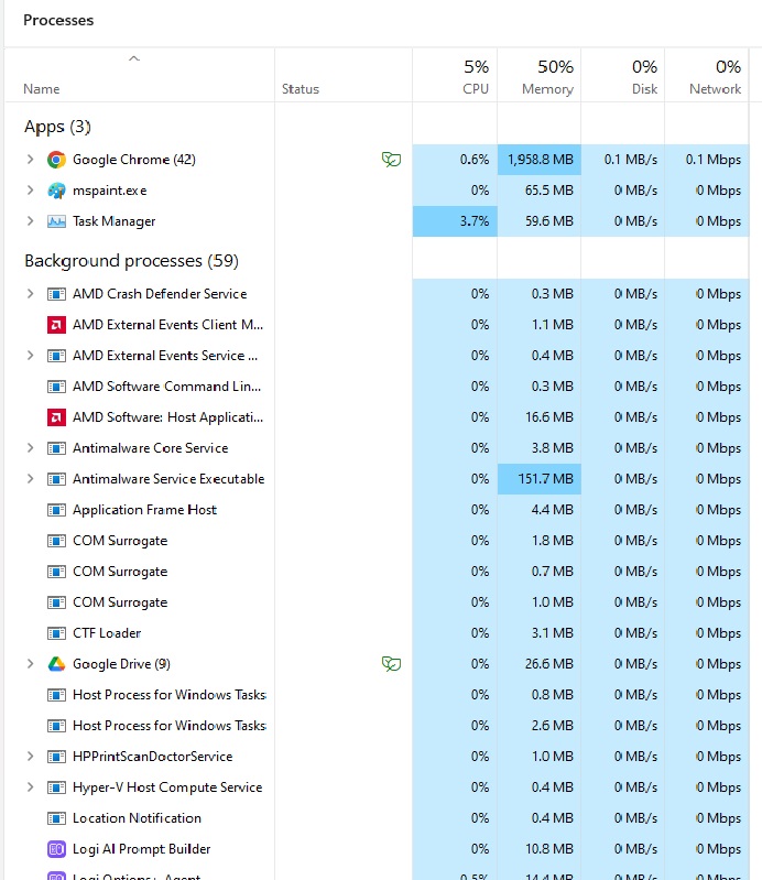

Posts: 8306
This is with a Youtube playing in the background.
Doesn't look like anything playing up?
Posted : 28/11/2024 2:08 pm
Posts: 624
Shut most of your 42 tabs?

Posts: 1330
Doesn’t look like anything playing up?
Agreed, assuming it was symptomatic when you took that screen capture nothing is jumping out at me. Chrome is high memory usage but not excessively so (mine's about 1.5GB).
Posted : 28/11/2024 3:42 pm
Posts: 1330
That's processes, not tabs. Mine says (19) and I have way more than 19 tabs open. Probably more than 42, even. You're right though, that's a lot of processes.
Chrome should start unloading inactive tabs to save RAM, though that does seem to be hit and miss so is maybe site-dependent (it works with STW). Oh - wait, that'll be it won't it, it's a process per active tab. Which would imply that the OP hasn't got 42 tabs open, he's got more!

Posts: 1886
Grab a screenshot of task manager if it occurs again (and sort by CPU% by clicking it on the headers).
A common cause of these symptoms is the .net optimisation service running after an update has been installed in the background.  On a slower CPU that can take effing forever, and AFAIK you just have to let it run its course.

Posts: 8306
I didn't have 42 tabs open when I took that screenshot.
I think it was 4.
Why is Chrome running so many processes?
