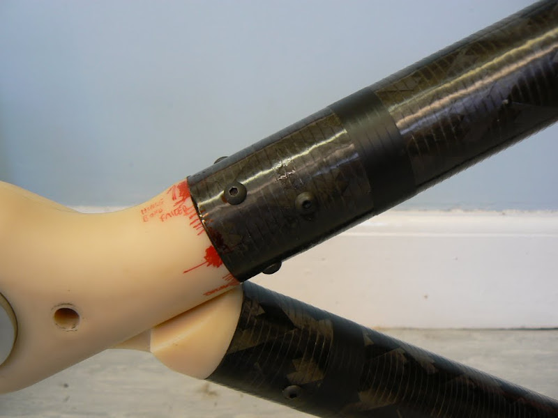

I was getting a little carried away earlier - the stuff I used on my post grad project isn't 'consumer' stuff. You can probably get hold of it through RS or another industrial supplier though.

That's actually how my project was held together although I did the sums and needed a much larger contact area than you'll be getting. The pigot goes inside the carbon fibre tube almost 2 x Diameter. When one of these failed I repaired it by drilling through and holding with lots of screws, which luckily didn't cause the tube to split.

/edit - and it's worth saying that in my model in the photo above - I had [i]excellent[/i] coverage. I machined applicator nozzle holes through the CF tube and grooves in the spigot inside to guide the epoxy and fill the gap up. You can see the epoxy filled remains of the hole if you look closely (just above the right hand most screw). I'd then pump the gun until araldite was squirting out of the ends of the spigot, and then some.
And one still failed.
