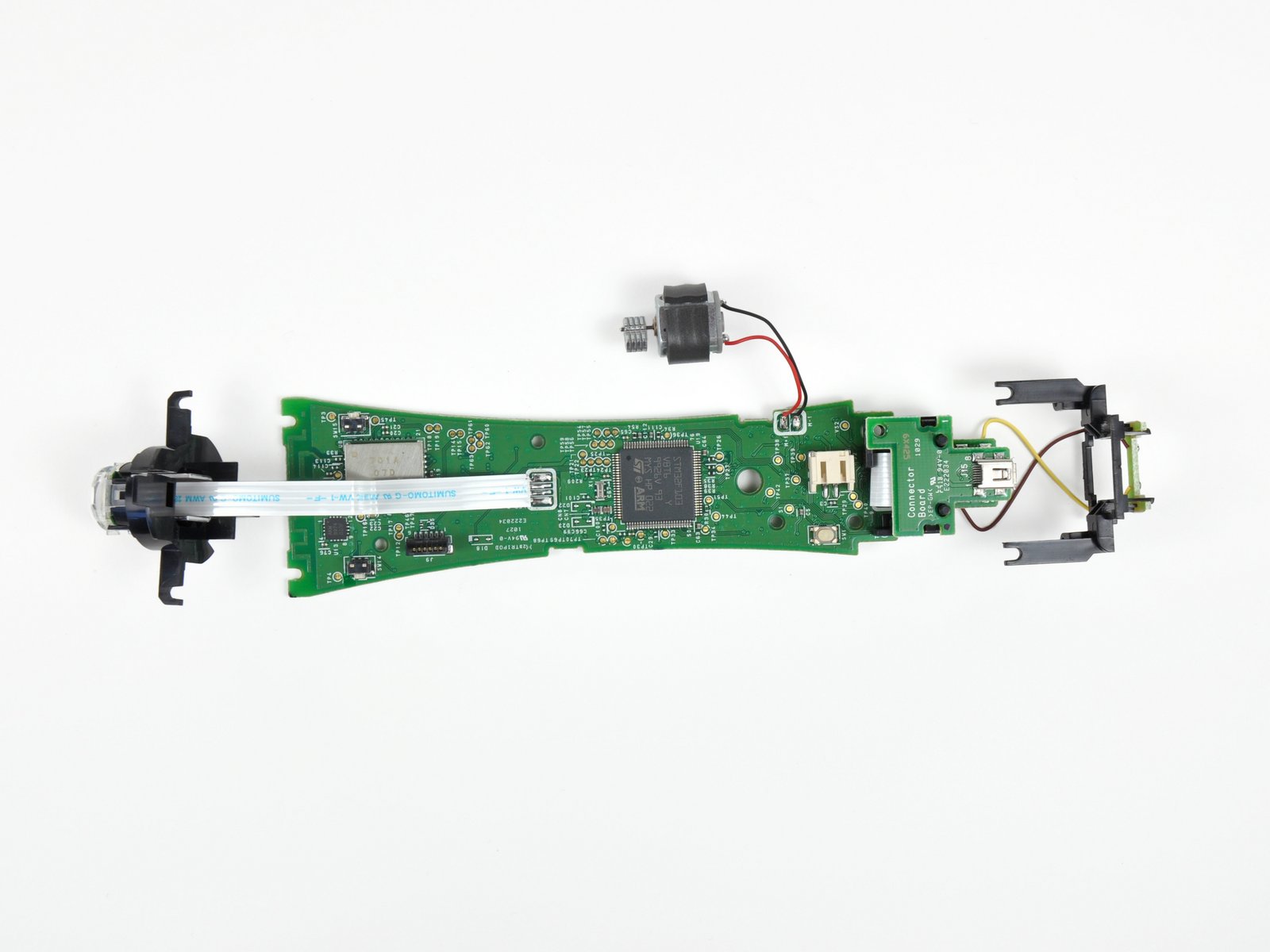

A cable broke in my Playstation Move controller. It's a ribbon cable with four wires, and they and their contact patches are just about thick enough to solder, I think. But it's going to be hard to strip the insulation off without damaging them.
So can I use acetone or something to melt the insulation? Is there some other trick that I don't know about?

Having a look on the ifixit page for the move controller it looks like you have a FFC (flat flex cable) in there to connect the LED. I'm guessing this must be the ribbon you're after fixing as it doesn't look like there is anything else in there.
Unfortunately these are normally covered with polyester which potentially means something like nitric acid if you want to chemically remove the insulation. So taking a scalpel to it is probably still your best bet. If you are lucky you might be able to get the edge between the insulation layers to separate it that way, otherwise there will need to be quite a bit of careful cutting/scraping.

Posts: 90742
Whole cable is 6mm wide for reference.
Stripping with a blade is what I'd normally do but it's quite destructive as there's a lot of plastic to remove here.

Posts: 90742
Thanks for the chemistry check @bigginge. It is that exact cable yes.
And it's not *just* a Playstation controller. For starters, Sony ones aren't cheap items anyway, but this is a PS Move controller and they are quite hard to get now.
One side appears quite thin though so I may be able to scrape one side off and then peel the other back and trim it.

Posts: 90742
what are you actually trying to do, repair the cable?
I need to fix the cable back onto the board. It's broken off right where it was soldered on directly to the PCB.
Those are usually connected with an IDC connector which is pressed through the cable to make contact: no stripping required.
This one was soldered directly to the board as you can see in the pic which has led to its untimely demise I am sure. I'll have to try heat. I've ordered a new soldering iron with a temperature control and a needle tip, wish me luck. My daughter cannot play Job Simulator with only one move controller.
