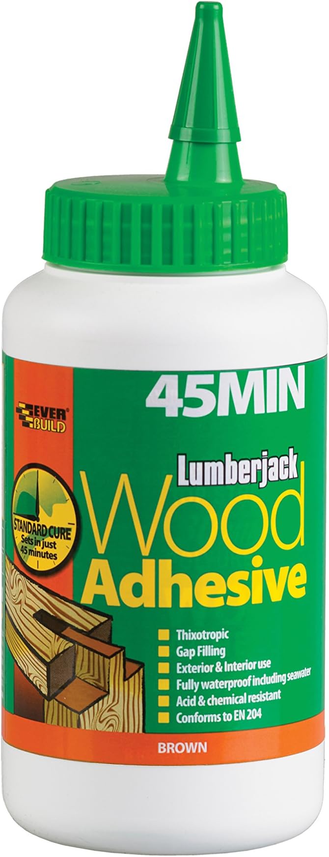

If the boards are tongue and grooved together, then often the tongues are glued.
Therefore, talking them up will be impossible without cutting.
I stopped our staircase from creaking by liberal use of expanding polyurethane glue.
Quiet as a mouse now.
I would try Sandboys approach with the caveat that you don't want to stop it being able to freely expand and contract.
