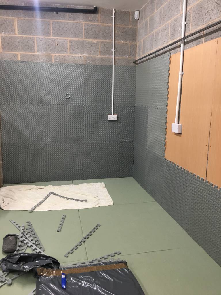

 bruk
Posts: 1781
I used B&Q's own spray contact adhesive when putting the floor mats on the wall of my mini mat area. 2 years later and after abuse of 2 small boys bouncing off them they are still sticking perfectly.
Wall mats going up
