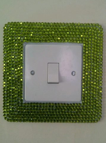

Something fancy like this
http://www.amazon.co.uk/Single-switch-finger-plate-colour/dp/B004HYD39U
You can get them in white
Posted : 16/12/2014 5:26 pm
http://www.amazon.co.uk/Surround-Coloured-Acrylic-Decorative-Perspex/dp/B00H9F3SO4/
(And many, many more...)
Posts: 3544
Lime green diamonte surround. Mmmm, it might just work....
