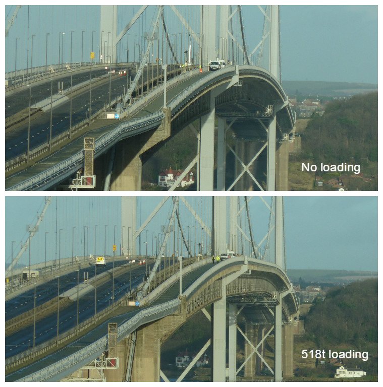

It was loaded up with gritter trucks earlier today to see how much effect load is having
Posted : 08/12/2015 4:54 pm

Impressive tests;
Posted : 09/12/2015 5:01 pm

I done this:
Posted : 09/12/2015 5:35 pm

Wot GrahamS actually did:
Who knew it changed colour when you put a load on it?
Posted : 09/12/2015 6:09 pm

that's excellent engineering - colour response to load changes!

Is it not working Mr C? I can see it.
Try the link instead: http://postimg.org/image/cbpnr5hab/

Photoelastic measurement in action. Awesome!
