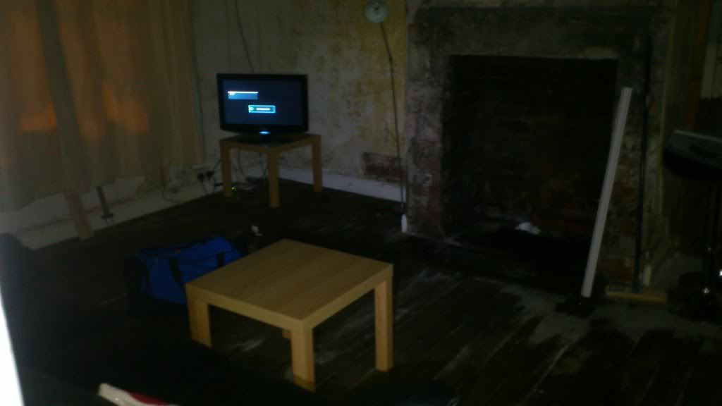

Posts: 12329
How dare you t-r; the front room/squat is coming along nicely...
