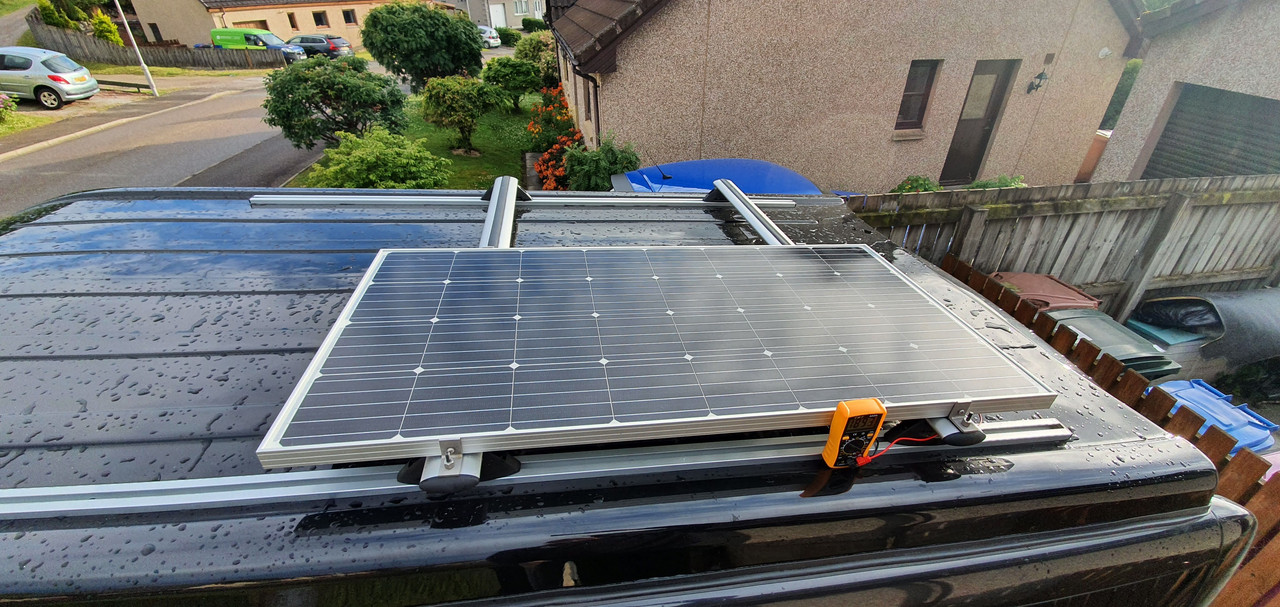

I have a Trafic with a poptop and had a roof rack fitted and bolted a 160w panel to that. I haven't turned my fridge off since I switched it on in June. The added bonus is I can fit our Thule ski box to the roof to carry folding chairs/tables etc in it.
Solar panel on poptop

I had the roof bars fitted at the same time as the roof, all covered under a warranty then. I did make the brackets, bolt the panel on, cut the holes in the roof and wire it all up myself though.
[url= https://i.postimg.cc/52S7pZZT/20200712-120813.jp g" target="_blank">https://i.postimg.cc/52S7pZZT/20200712-120813.jp g"/> [/img][/url]

I went for the rigid panel for the reasons trail_rat describes above, dead easy to change if needed. I also went for a Victron controller, it seems to just get on and get the most out of the panel. It might be overkill but I never have to worry about power.

@swavis Don't you worry about that plastic hose taking the paint off the roof while you're driving?
Posted : 30/09/2020 9:58 am
Posts: 3003
Nope it's not painted, it's black fibreglass. The hose is rubber and actually quite rigid so doesn't move much. I'll keep an eye on it though but nothing visible after 4 months of being up there.
