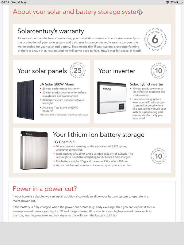

This is what our friend had installed. At that price I would possibly have 2 batteries.
The deal breaker is for us to be able to use the batteries in a power cut. The Tesla installer said it would be ok.
Posted : 06/05/2020 8:16 am
Posts: 822
A Tesla powerwall is 13.5 kWh - so more than twice the size of your friend's 5.9 kWh install. I'd also check the guarantee (Tesla is 80% capacity after 10 years) and efficiency.

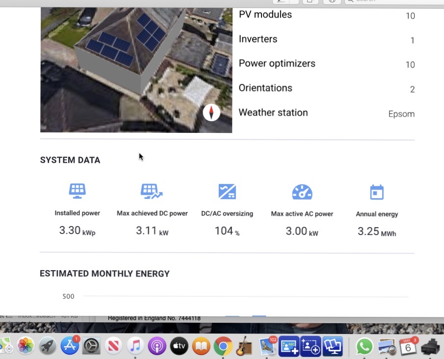

What size system is the Panasonic, 3.3kw?
My advice would be spend the money buying a larger system, if you have room for it before spending thousands on a battery.
I have a 4kw system.
Stats for last 30 days
Generation - 410kw
Generation into battery - 135kw
Exported to grid - 25kw
Remainder of 250kw used to feed the house straight from system.
Stats may be a little off as we have been home so generally use high loading appliances in the day, but I find on dull days the system does not generate enough to put any substantial amount into the battery, so For half the year it saves nothing. Had decent weather for the last month, I figure the saving from the battery to be
0.15 x 135 = £20, will take a long time to get 8 grand back, I cannot see there will be many days it will feed the house and fully charge battery. Obviously every household is different. 2 kids, washer / dryer / dishwasher on daily + electric shower probably puts us as high users.

This is what the panasonic/tesla man in supplying. The numbers mean nothing to me!

My main motivation to have a battery is in case of power cuts. They are building houses on the playing fields near us. I'm pretty sure they will do zero work to upgrade the grid and over load it completely.
The shops opposite our one regularly have cuts as the office block on the corner is now flats and the grid can't cope when everyone is at home during the day.
Posted : 06/05/2020 5:18 pm
Posts: 36
The PW2 won’t work or power your house in the event of a power cut.
Posted : 06/05/2020 5:30 pm
The man that quoted us said it could. I asked him several times. There must be a gubbins that lets it do it.
Posted : 06/05/2020 6:06 pm
Posts: 36
He is wrong
Won’t work like that in the UK
Posted : 06/05/2020 6:22 pm
Tesla are claiming it is possible but you have to set a reserve amount in the battery to utilise in power cut, say 30% but this is redundant any other time, so depends on whether you feel this is worth it for a couple of cuts a year.
As sharkbait said if it’s value for money your after I would look at solar + diverter, this does need an immersion heater but will trickle feed the tank any excess that would otherwise go back to grid, there about £300
