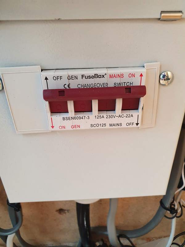

Posts: 13741
Manual would not be allowed, it would need to be automatic.
My manual change over switch
Posted : 18/01/2023 9:32 pm
