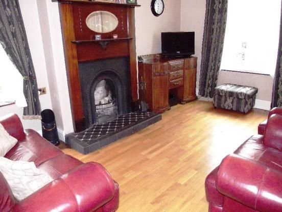

in the house we are buying and having never had one before know very little about living with one.
I think longer term we will replace it with a woodburner but for now its staying put
I understand draughts can be a problem, would putting in a pipe from the outside with a valve on to adjust airflow be a good idea? And if so where would you put it, directly behind or at the side?
Wood or coal, thoughts?

That looks like an original fire and surround? I certainly wouldn't be removing that for a wood burner, that would devalue your house.
Wait until you've tried it and see how it burns before you start adding pipes in.

lets be honest though chaps , character or not ... that mantles boggin - i like the cast fireplace but the mantles just urg.

The wife wasnt overly keen on the wooden surround. Its a 30's house (i believe) so it probably is original to that era. I think the mirror has to go as a start.
Wood isnt/wont be a problem as a friend has a paintball park in an old forest/coppice so i just need a trailer or use of his van, he is happy to decapitate himself with a chainsaw!
I dont anticipate the house being that draughty, seems better than our current mid 90's thing with old wooden double glazed windows and a wooden front door. Has good double glazing, GRP front door and UPVC rear with UPVC patio doors hence thinking about a vent pipe. I thought this would allow heat to rise upstairs as oppose to being sucked down?
Any suggestions for blocking it up when not in use? Is there any kind of inflatable device you can pop in for example or is it just a case of chopping a bit of board?

Seems the cast surround is going to stay but the wooden mantle and surround will be in the for sale section soon.
Roll on building a mini mcmooter wood store!
There is another one in the opposite room but that has a gas fire in at present, wife wants to remove that completely as it will be the play room. Might have to open up the opinion of the STW fire loving public on that one but it may well be safer not having some form of limestone lump protruding into the floor of a playroom (to return as soon as the kids grow up!)
